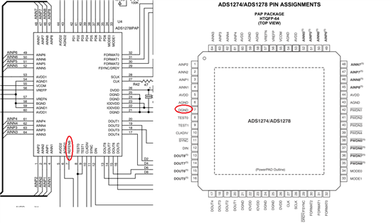

I'm reviewing a custom ADS1278 design and comparing it with ADS1278EVM. In EVM documentation I can see the pin 7 labeled as REFENB meanwhile in the datasheet the same pin is labeled as DGND.
At the end, this pin should be left floating or must be tied to DGND?
