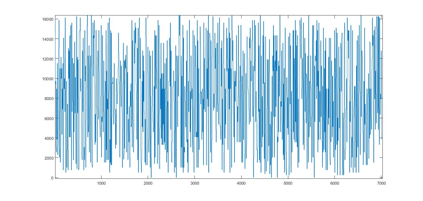

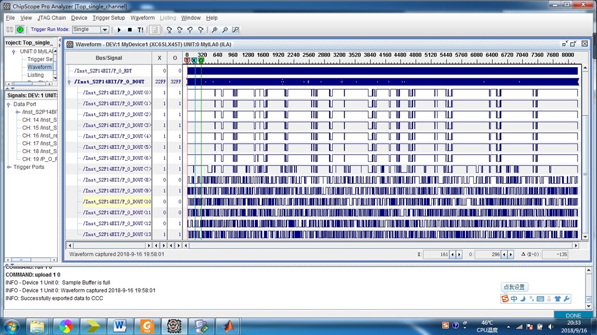

I have made a custom board that use AFE5809 as ADC. I can read the sampled data through FPGA and show the wave form in CHIPSCOPE (an xilinx IP core).
I found the noise is much too high, it seems like the lowest 6 bits are just noise. I have tested the LVDS capture codes using 5809's ramp patten and it is OK.
there is no other pre-amp stage before the 5809 input. the noise at the input pins are about 10mVpp (more like self noise of the oscilloscope)
noise shown in chipscope

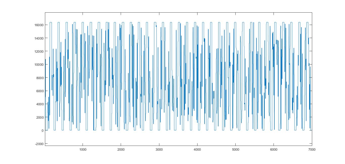

noise in MATLAB
waveform when a 40mVpp, 1MHz sine wave is added to the input.

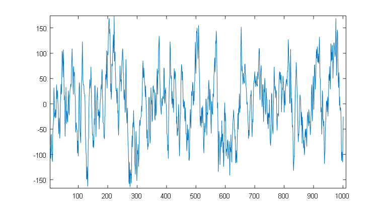

  • turns out the MSB of a bus in the chipscope is at the bottom. after I reverse the bus bit order, I can get noise data as follow:(sample clock is 30MHz )

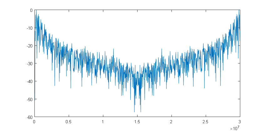

    and the noise spectrum:
    which is quite different from figure 12. LPF Response of the 5809 datasheet, i mean the high frequency attenuates much faster here.

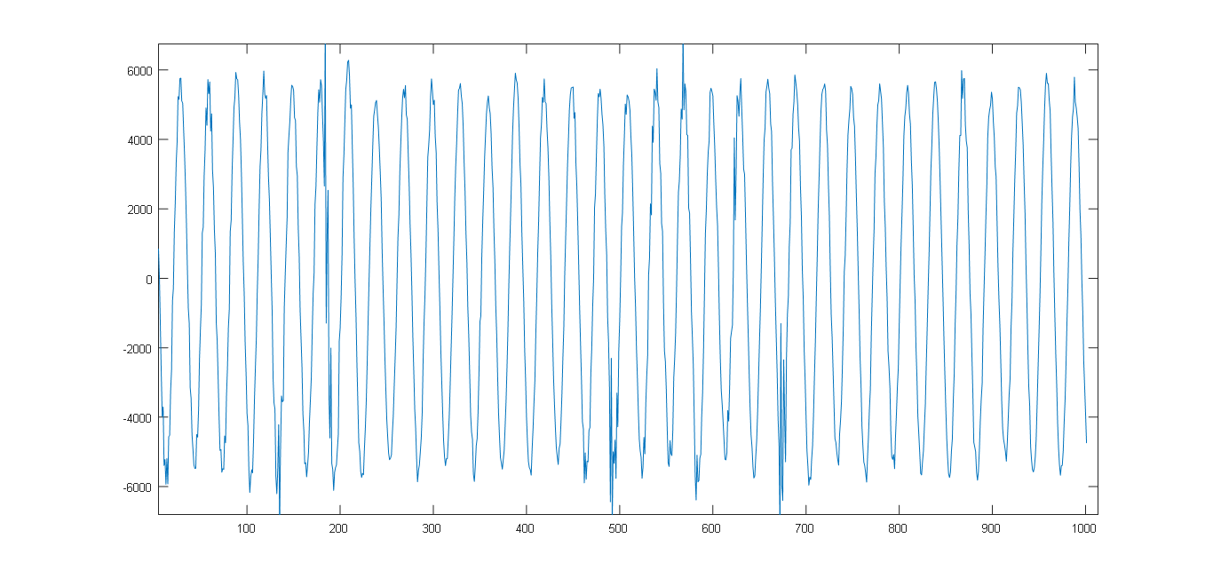

    below is the waveform when a 1MHz, 3mVpp sine wave is added to the input.
  • Hi Feng,
    How are you?
    Thank you for using TI AFE5809 device.

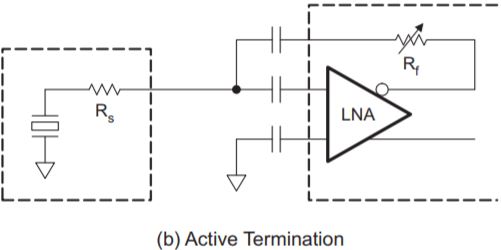

    For your high noise issue:
    Could you please double check the input set up shown as below:
    Please make sure your input signal is not floating
    (here is one example of the input channel's setting.)
    before capturing any data from that channel.
    Thank you very much!
    Chen
