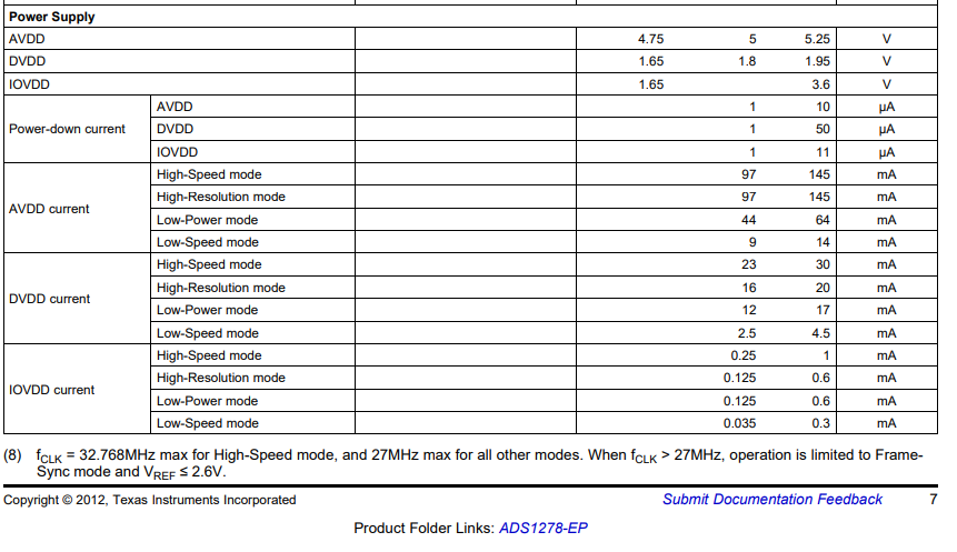

I am performing some stress analysis and would like to know how much would be the power consumed typically per channel in High speed mode and High resolution mode.
There is information about the other modes power consumption per channel in the datasheet but not what I am looking for.
Also, all the electrical specification are assuming all the channels are active, what would be the case when only 6 channels are active and 2 unused.
also should the unused channels tied to ground?? I am think they should not contribute any power consumption.
