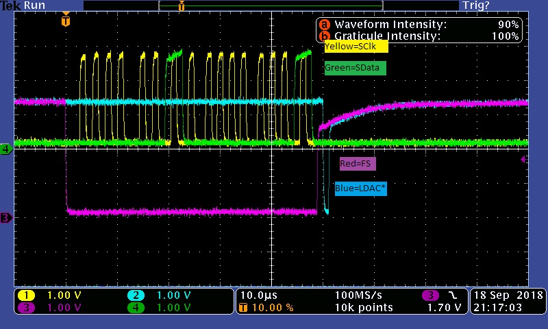

The TLV5614's rev B datasheet does nor address the LDAC* pin's timing requirements.  Can some insight be provided?
Background   I'm having issues with the output updating consistently.  Seems to update every other time.
I'm following the datasheet timing requirements to load the register, which are:
CS* low, then FS low.  Then load 16 bits while both CS* and FS low.  Then FS hi.
After this (update of the input register), pulse LDAC* low.  The delay (after FS hi before pulsing LDAC* lo) = ~1us, and LDAC* is low for ~1us before returning LDAC* HI.
Any specs or suggestions?

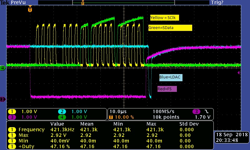

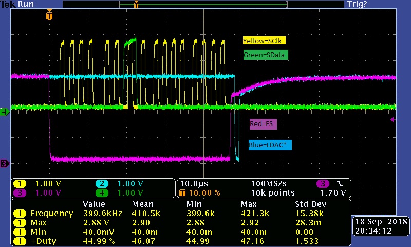

    TLV5614 Bench Results
    The first 3 figures are scope traces, then analog values. The 0V baselines are different for 2 signals (centerline for 2, 2 div's lower for the other 2).  The clock reaches ~2.8V quickly, same as other signals.  DVdd = 3.3V
    Datasheet Vih = 2V for DVdd=2.7V
                            =2.4V for DVdd=5.5V
    Input code 0x01FF
    Input code 0x0200
    Input code 0x0201
    Various DAC0 hex input codes and DMM measurements of DAC0 Outputs.
    AVdd=5V. Vref=2.048V. Vout = 2*Vref/(input code), 1LSB=1mV.
    Notice the output moves for only every other input code, even at the low end.

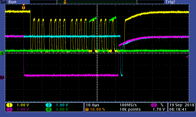

    The solution I found is:  SClk must be normally high.  Scope of successful data input is below.  According to datashet p.13, clock MUST go high after FS goes HI (again no mention of LDAC).
    Therefore, I conclude the datasheet's Figure 1 (p.7) is incomplete (no LDAC* signal); and either in error (or misleading) since SClk can NOT be "don't care" at the end of the sequence, it MUST go high.
  • I moved the SClk (yellow) last rising edge to occur before the LDAC* low pulse, and before FS rises.  Although not explicitly stated in the datasheet, it seems consistent with the example programs, specifically if updating DACs simultaneously.
