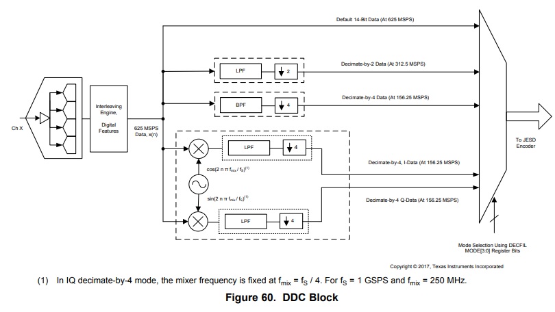

We are trying to process BW 400Mhz and below 1Ghz center frequency with ADS54J60.
The block diagram is the same as the ADS54J40.
If you look at the block diagram in the document, it becomesDefault 14-Bit Data(At 625 MSPS).Is it an error?
Default 16-Bit Data(At 1GSPS) is right? Is it wrong?
Or is the actual sampling to 625 MSPS instead of 1 GSPS due to the impact on the ADC Core Interleaving Engine?
