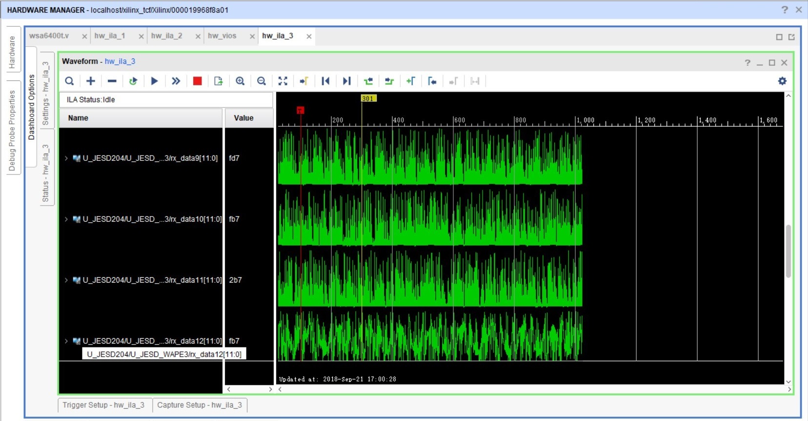

Hi:
My Configuration Files as:
ADC12DJxx00
0x0000 0xB0 // Do soft reset
0x0200 0x00 // Clear JESD_EN (always before CAL_EN)
0x0061 0x00 // Clear CAL_EN (always after JESD_EN)
0x0201 0x00 // Set JMODE0
0x0202 0x03 // Set KM1=3 so K=4
0x0204 0x01 // Use SYNCSE input, offset binary data, scrambler enabled
0x0213 0x07 // Enable overrange, set overrange holdoff to max period 8*2^7 = 1024 samples
0x0048 0x03 // Set serializer pre-emphasis to 3
0x0061 0x01 // Set CAL_EN (always before JESD_EN)
0x0200 0x01 // Set JESD_EN (always after CAL_EN)
0x006C 0x00 // Set CAL_SOFT_TRIG low to reset calibration state machine
0x006C 0x01 // Set CAL_SOFT_TRIG high to enable calibration
ADC DCLK: 3200MHz;
when input a sine wave(3.2MHz), output wave as:
rx_data0:s0,rx_data1:s1, ... ,rx_data19:s19;
can you help me to analyze a problem mentioned above? any error in configratiom file?
