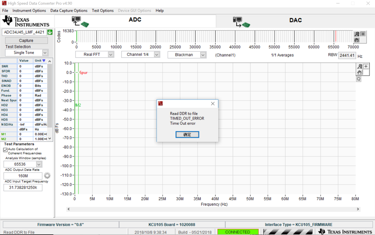

Right now I can use the HSDC Pro GUI. But in the device dropdown menu I did not find the Board ADC34J45EVM. Could you please tell me how to deal with it?

https://e2e.ti.com/cfs-file/__key/communityserver-discussions-components-files/73/ADC34J45_5F00_LMF_5F00_4421_5F00_new.iniUser,
Install the attached file in the following location:
C:\Program Files(86)\Texas Instruments\High Speed Data Converter Pro\KCU105 Details\ADC files
Jim
KCU105 ADC3J45.pptxUser,
Please follow the instructions in the attachment. There are a couple of things you need to change in the HSDC Pro GUI, mainly the sample size.
Jim
