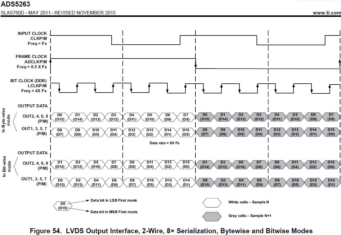

 It is a mention of DIGITAL OUTPUTS of DataSheet Page3.
ADCLKP and ADCLKN outputs (LVDS), two-wire     0.5x(sample rate in MSPS) MHz
 This is an error.
ADCLKP and ADCLKN outputs (LVDS), two-wire     1x(sample rate in MSPS) MHz
 I think that the above is correct.
 The reason is Figure 69 of DataSheet Page77.
 Figure 69. LVDS Output Interface Timing Diagram
 (Two-Wire, 12x Serialization, Byte-Wise and Bit-Wise Modes)
Input Clock, CLK Frequency = fS
Frame Clock, ADCLK Frequency = 1x fS
 CLK and ADCLK are listed with the same frequency.

    Yes, The ADS5295 datasheet Page77 has some typos.
    The datasheet Page3 spec is correct.
    There is one similar with earlier revision device which is ADS5263 16-Bit device.
    ADS5263 device also has Two-Wire mode, CLK, Frame Clock,
    Byte-Wise mode and Bit-Wise Mode.
    (But ADS5295 has 12-Bit adc, v.s. ADS5263 has 16-Bit adc)
    Therefore, please take a look at the following ADS5263:
    datasheet's digital output plot (this plot is correct):
    (Hope you can understand why ADCLKP/M Freq is 0.5*Input CLK's Freq)
