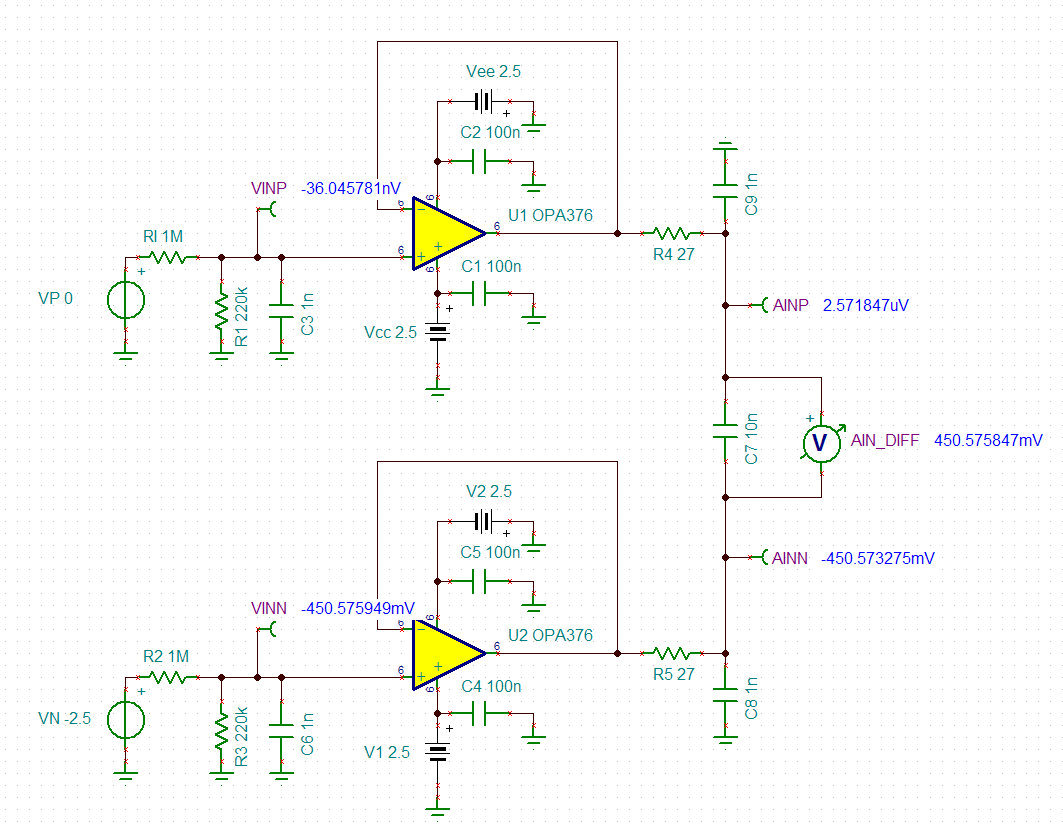

  • Thanks a lot for fast reply. It's much clearer now. i written function which convert value from adc as follow: func(0x7fffff) -> 8388607, func(0xffffff) -> -1, func(0x0) -> 0, func(0x800000) -> -8388608. lsb is 2.5/(2^23-1). When i connect a AINP ans AINN to GND i get mean value is -0.00031636482115048476 V and standard deviation is 3.08254161480825e-06. I think it is normal result. But, when i connect AINP to GND and AINN to AVDD/AVSS i get -0.45/0.45. I expect get -2.5/2.5 or  -1.25/1.25, isn't it?

  • Hi Christopher.
    I attached full schematic to my first message. So, on AVDD +2.5V, on AVSS -2.5V, on VREFN -2.5V, on VREFP small positive voltage (fractions of millivolts). When i said connect "AIN to AVDD/AVSS" i mean connect for a short time to get measured value from ADC, two different cases (i used it as known signal source +2.5 and -2.5 V), So, i expected to see almost the same results afters ADC conversion.

    I simulated your OPA376 circuit and was able to reproduce the same result:
    Notice that the "VINN" input voltage is about -450mV due to the resistor divider on the input of the opamp.
    TINA-TI File: OPA376 Circuit.TSC
    Chris
