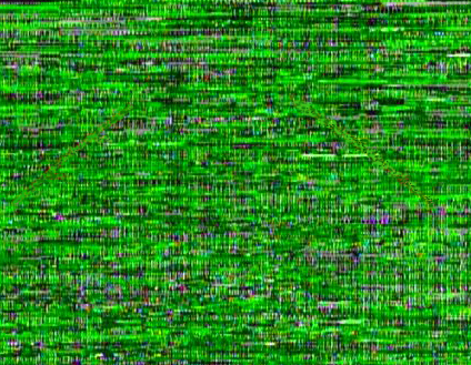

I am run-in test for power on then off repeatedly. Sometime one of tvp5154's decoder output wrong video image and others is normal.
I get image form abnormal decoder as below. Someone can give me suggestion for this situation.
Really appreciate your help!!

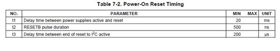

    We alraedy check our design meet  datasheet  section 7.3 Power-On Reset Timing requirements.

    We do not understand, why the commands all send to TVP5154A four decoders at the same time, but one of the decoder core (sometimes decoder code 1, sometime decoder core 3) is failed.
    We had add some test code to read back all REGS we configed when the initialzation failed; we found sometimes the failed decoer core's REG 03h become 0x32 (the value shall be 0x6D), and sometimes all REGS of failed decoder core read back are all the same as we configed but it still failed.
