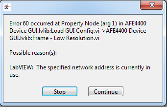

AFE4400SPO2EVM: AFE4400 SPO2 EVM gui error
Part Number: AFE4400SPO2EVM
I have installed AFE44x0SPO2EVM gui on windows7. When running the application i am getting following error. I have tried to re-install the application but the same result.
  • Hi Anish,
    Few suggestions to debug this issue.
    1) Make sure that the EVM is detected by the PC as "AFE44x0SPO2-FE EVM". For this you can check the device manager. If not, then follow the steps mentioned in the section 3.3 of the EVM's user guide to install the driver.
    2) If EVM is detected properly, then try to change its COM port number to some other value (greater than 25) and give it a try.
    Prabin
