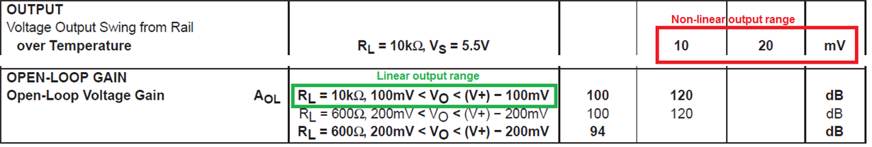

I was using INA188 to measure the battery voltage in differential mode. And give the output to a single ended ADC.
Now I plan to use ADS1256 SDADC in differential mode to measure my battery voltage. Can I just take off INA188 and feed in the battery terminals to SDADC pins ? If yes then do I need any signal conditioning circuitry.
