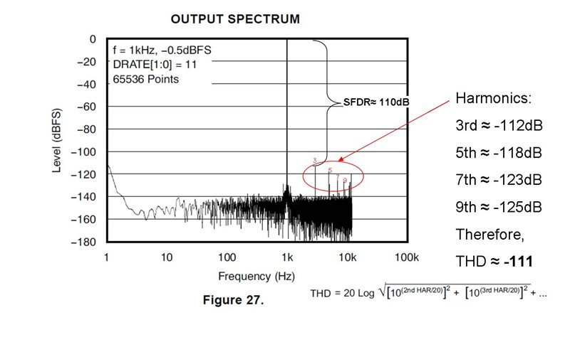

Hi to everyone,
I am thinking about using ADS1258 but I don't find the following parameters for this device:
SINAD
SNR
SFDR
Does anybofy know it?
Thanks in advance.
Nuba,
Is your application AC or DC oriented? I would assume that your application is monitoring some sort of AC input signal. If that is the case, I would recommend looking at one of our SAR converters, maybe the ADS795x series parts. AC specs are going to be better when going to a SAR converter. Delta-sigma converters are focused towards DC applications.
Tony Calabria
Hi Toni,
I am goint to monitor sensor outputs and do some DC supply tracking. I thought that this AD would be OK since it can produce sensor bias current, and their main aplication are Measurrement systems and Instumentation.
Right now I am using a Pipeline ADC embebed in a C2000, but I need more resolution, EP version and 16 channels. That is why I am thinking about ADS1258EP.
Would this ADC be ok for MEMS sensors and DC supply tracking? The cut frequency of my filter before the ADC will be 50 Hz, so I guess my app. is not considered "true AC".
Anyway, I would like to know these parameter if anybody know them.
Thnaks in advance.
Hello Nuba,
It is possible to estimate AC parameters from figure 27 of the datasheet:
@ 1kHz
Noise floor ≈ 140dB
SFDR ≈ 110dB
THD ≈ -111dB
SNR ≈ SINAD ≈ between 100dB to 110dB
@ 50Hz
Since the noise floor is about 140dB, the SNR should improve significantly if the inputs are properly filtered. Just be careful with settling time.
