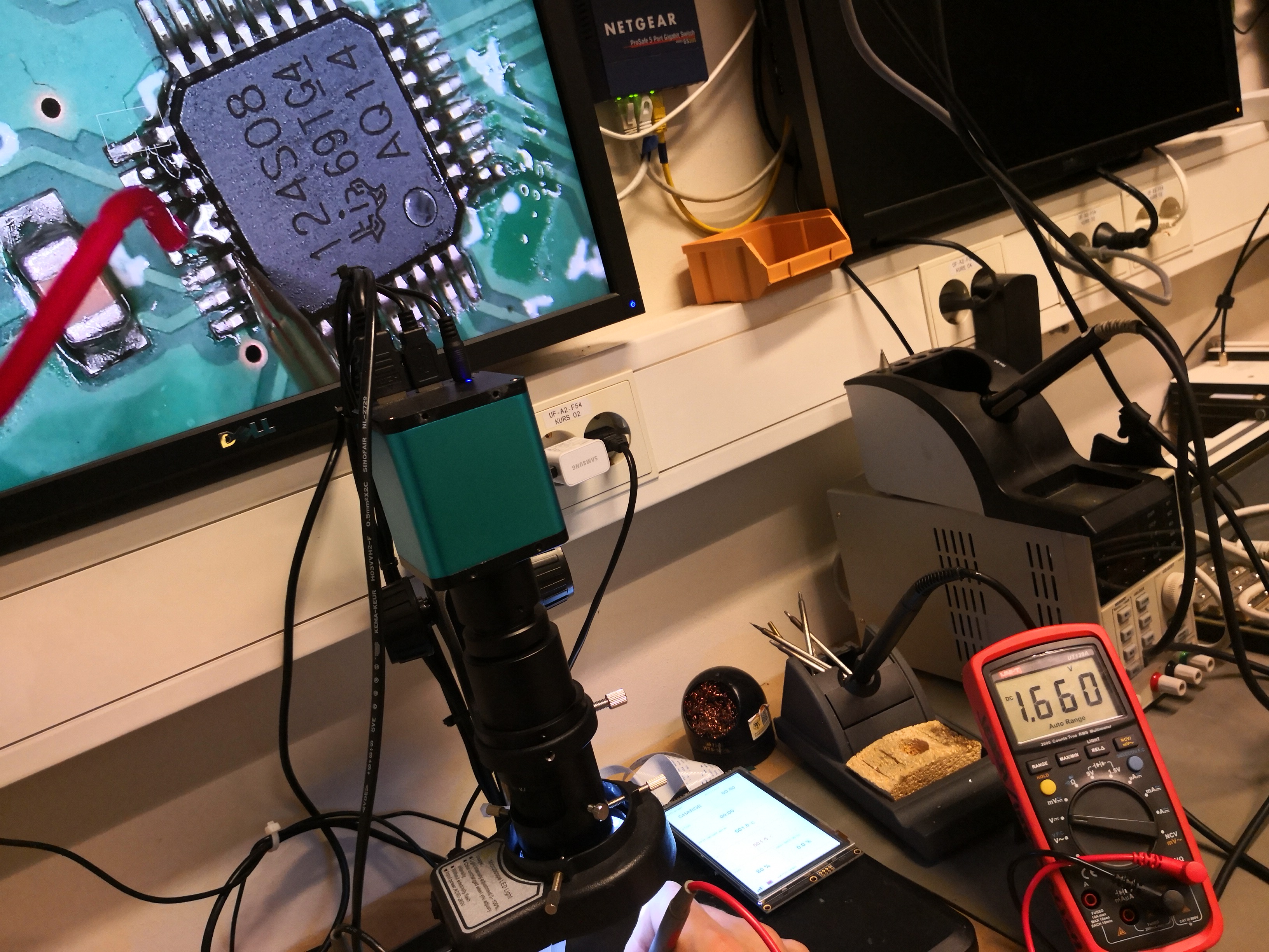

Connected to AIN8, I have a standard 100k NTC Thermistor (MPN: NB12SC0104JBB) that is connected as in the schematic below. When measuring with a multimeter on the test point W9, I get 1.67V. When I increase the temperature of the NTC, it rises and falls very precisely, so electronically all is good. My problem is measuring this with the ADC.

  • Hi Jens,
    Just to add to Joseph's comments, have you actually checked the voltage at the AIN8 pin of the ADS124S08?  I see you have a test point, but you really should verify that the same voltage is being seen at the device pin.  Make sure there is a good solder connection on that pin.
    Bob B
  • Thanks Bob and Joseph. I nailed it now!
    The problem was that my code was toggling between the RTD readings and reading the Thermistor. Once I measured on REFOUT I could see it turning on/off. The voltage on AIN8 is correct, but this switching just won't work as the settling takes too long time. The 10uF cap is there per the Application note on ratiometric measurements and it does indeed look like it messes this up :-/
    If I only read the Thermistor, I can read the voltage correctly. If I try to toggle between RTD's and Thermistor, it goes bananas right away. I'll just have to find an analog pin somewhere else I guess?
