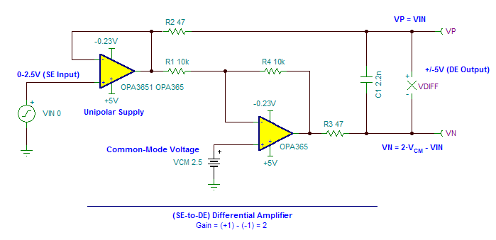

When input signal range to the device is 0 to 2.5V, what configuration do you recommend for best SNR performance? Although I think additional 1.25V can help for the situation, can AINCOM be used for the purpose?

    To make full use of the ADC's resolution, you typically want to try to utilize as much of the input range as possible. For a 0 to 2.5V signal, this is really difficult without some front-end circuit to level-shift the signal, which I generally discourage as this in-itself usually degrades performance. Some possible approaches might be:
    1. You could try to measure the 0-2.5V signal directly (and enable VBIAS on the AINCOM pin), but you'll find that the PGA's input common-mode range does not extend all the way down to 0V, so there will be linearity errors for small (<0.3V) input signals. The pGA could be bypassed, but your signal would need to be buffered.
    2. Power the analog supply from a bipolar supply, such that 1.25V becomes the mid-supply voltage (AVDD = 3.75V, AVSS = -1.25V). This way you can measure the input signal directly with the internal PGA in a gain of 1 V/V. This only utilizes the positive full-scale, so you would lose a bit of resolution
    3. Alternatively, using an ADC such as the ADS1256 would allow you to input a 0 - 2.5V signal directly, but here again you wouldn't make fully use of the ADC's input range.
    4. If you do decide to go with a front-end amplifier, you could do a single-ended to differential conversion, as shown below, but there are a lot of caveats to this circuit... If you gain up the signal by 2 V/V, you must provide a 5V external reference to the ADC, but the ADC's REFOUT can be used for VCM in the signal conditioning circuit. However, if you use the internal 2.5V reference, then you still need to provide an accurate 1.25V common-mode voltage to this circuit. In both of these cases, you will need to provide a slightly negative supply voltage for the amplifiers, and the additional noise and offset from the amplifiers degrade the performance of the ADS1261, so overall this is not an ideal use case for these devices.
