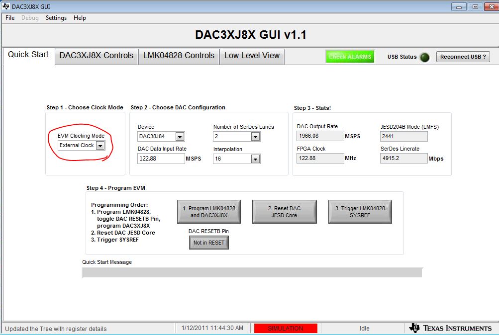

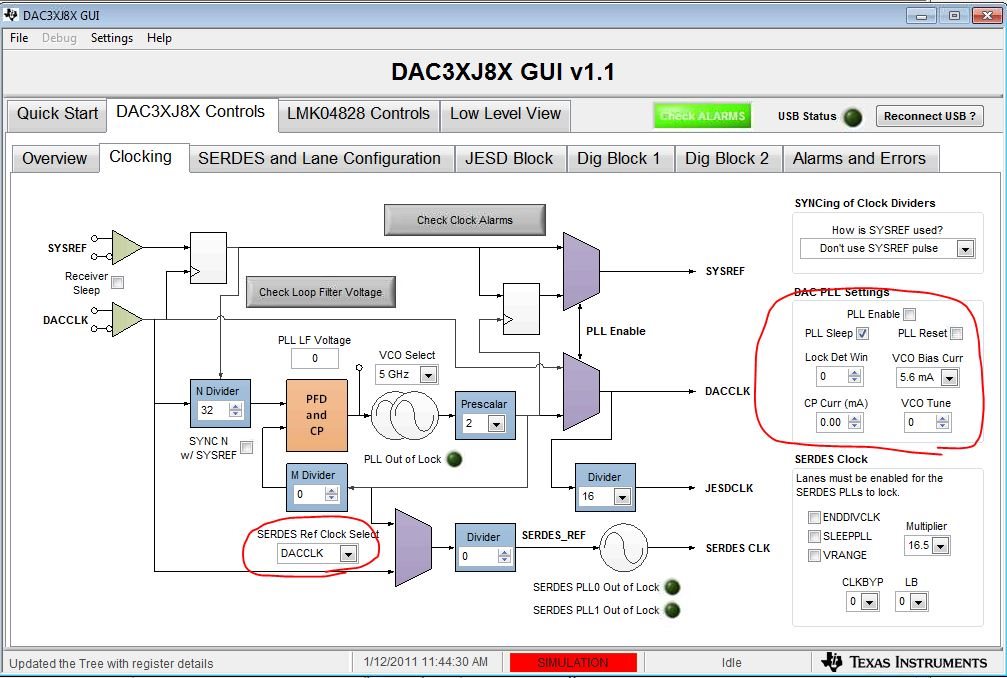

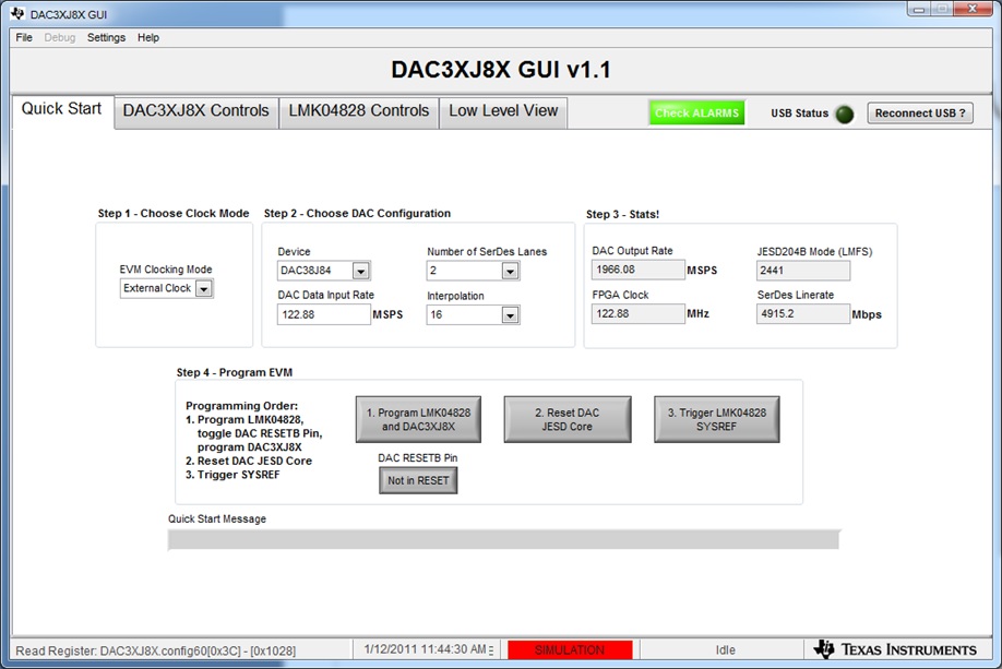

  • Hi Henry,
    Please help confirm if the customer is providing the 122.88MHz clock to the EVM, or are they planning on using the on-board LMK04828 to provide the 122.88MHz reference clock
    Basically, for the first step of GUI config, which one are they choosing?
    Could the customer also post various screen shots of the GUI so I can take a further look at their configuration? It is easier than looking through the various lines of codes.

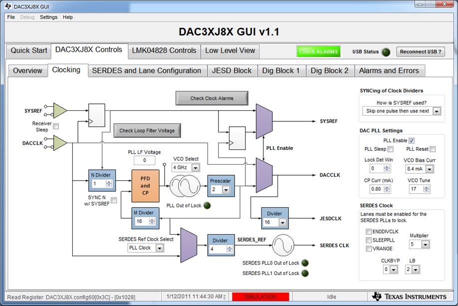

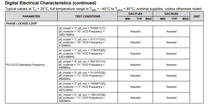

    The PLL settings can be set in the following GUI section:
    With the PLL setting listed in the datasheet below

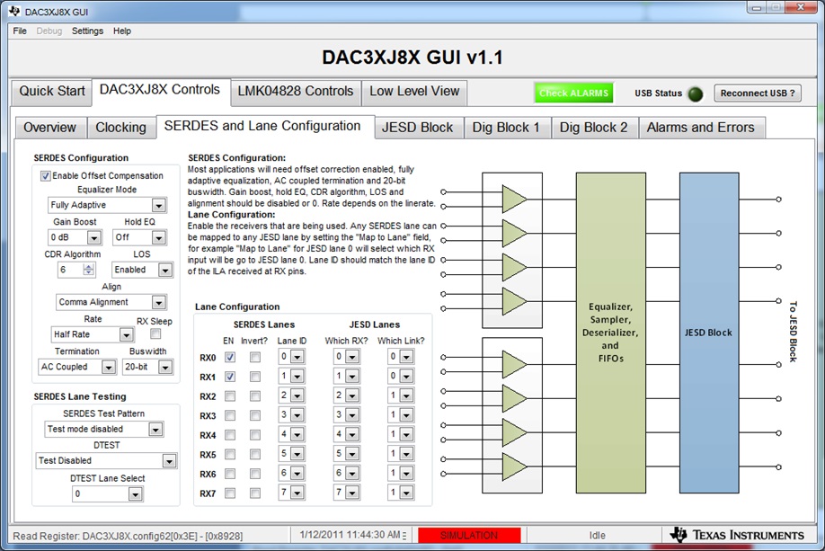

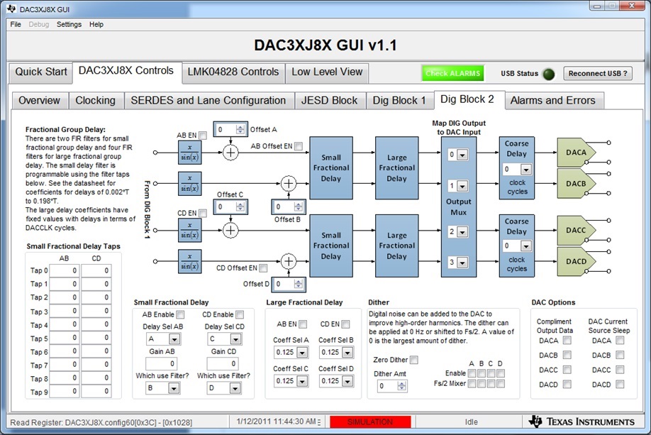

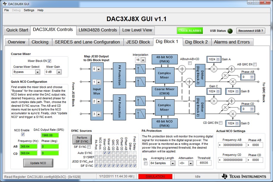

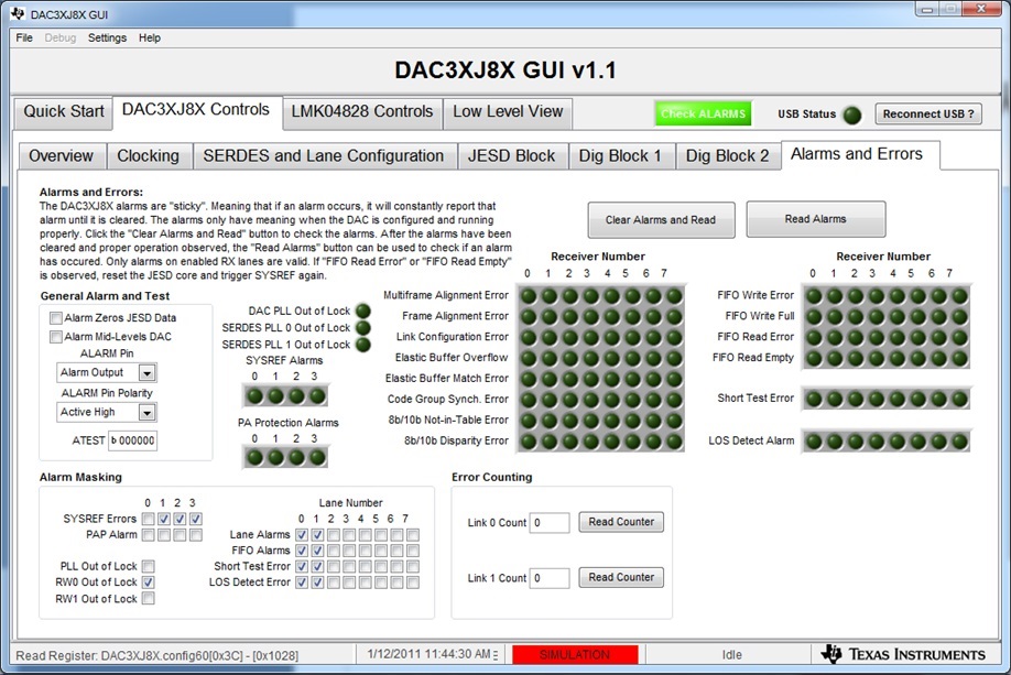

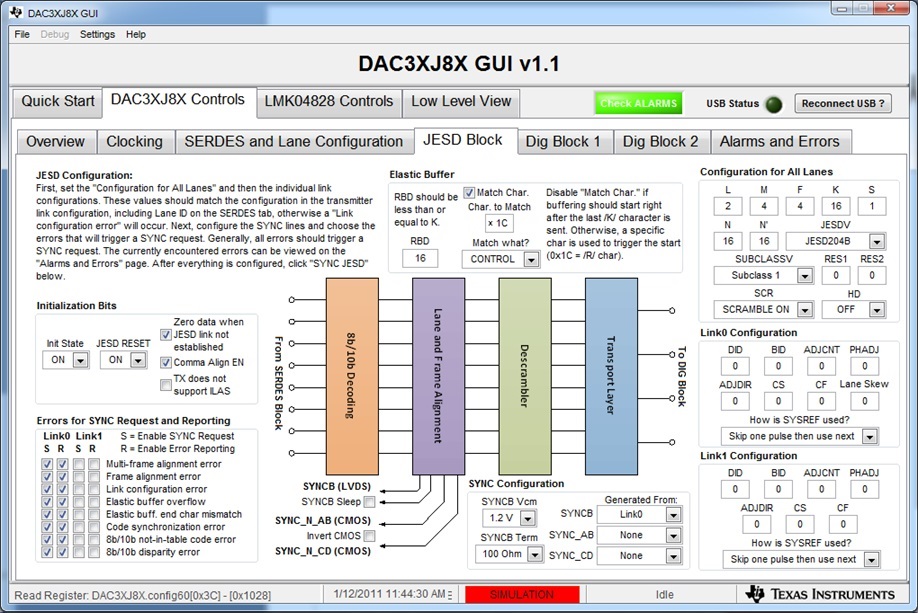

  • HI. KANG
    It is GUI capture as below.
    We need register values that match our setup conditions.
    Please, Review
    Thank you
