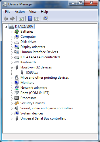

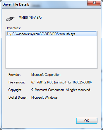

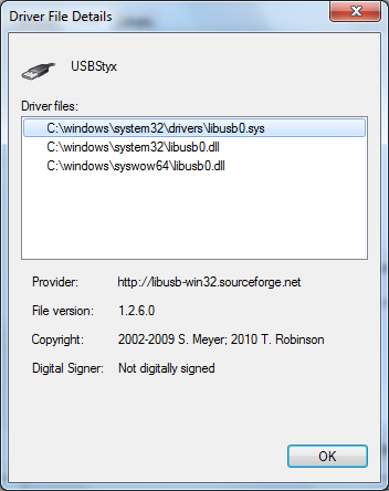

  • Hi Jef,
    In Device Manager, I'm expecting to see "MMB0 (NI-VISA)" when the EVM-PDK is plugged in, but the software has not been started. After running ADCPro and selecting the ADS1278 plugin, the device should re-enumerate as a "USBStyx" device.
    If you're trying to point to the drivers manually and you see an error regarding driver signature enforcement (DSE), this may be related to a Windows 10 issue where our older drivers are not properly signed for Windows 10. It's possible to disable DSE and install them anyway as others have done on this forum. Let me know if you think we need to try that.
    Here's what you should see in Device Manager:
    Before running ADCPro
