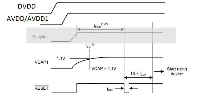

If RESET is not released, is power(AVDD/AVDD1/DVDD) sequence free?
For example, is below power sequence no problem?
Kuramochi
  • Hello Kuramochi-san,
    Thank you for your post.
    Yes, it is ok to allow for the power supplies (AVDD and DVDD) to ramp up while /RESET remains low. However, the POR counter will not begin until /RESET is released and CLK is applied.
    VCAP1 will begin to ramp as soon as /RESET is high. The tPOR delay remains the same - you must wait for VCAP1 >= 1.1 V and 2^18 tCLK periods, whichever is longer.

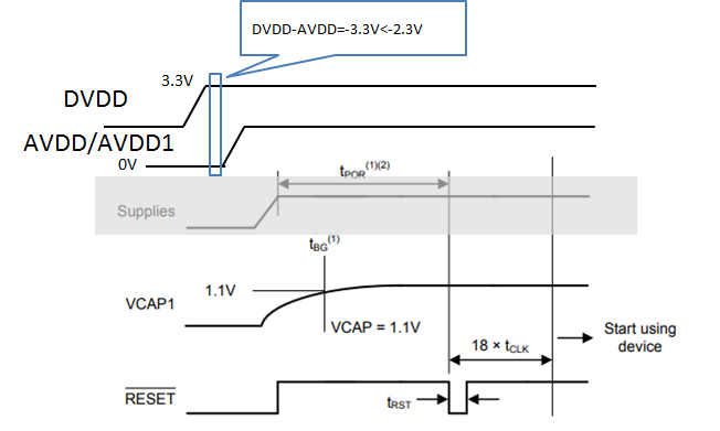

  • Hello Ryan-san,
    Thank you for your answer.
    I have an additional question.
    On the "7.3 Recommended Operating Conditions" of the datasheet, Analog to Digital Supply is specified "2.1V~3.6V".
    Is this valid after releasing reset?
    I would like to know if below condition is problem.
    Kuramochi
    The condition you described is not a problem during power-up. The Recommended Operating Conditions list the device configuration settings to achieve typical ADC performance. The spec "-2.1 V < (AVDD - DVDD) < 3.6 V" only applies to normal operation. As you can see in the Absolute Maximum Ratings table, we do not give a similar spec; therefore, there is no concern with damaging the device if DVDD = 3.3 V and AVDD = 0 V.
