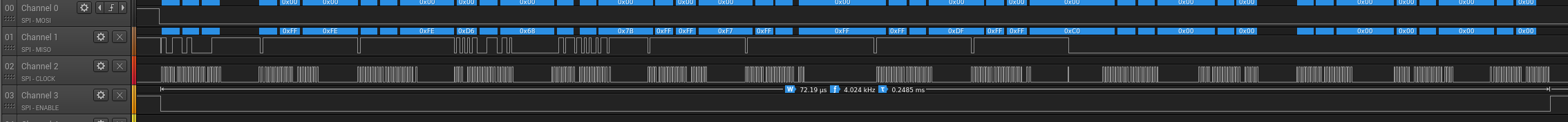

We are trying to use the RDATAC command to read data continuously from both devices. On a Logic analyzer we can see data from the first 8 channels, but in the remaining channels we get no data.
At startup we are setting the config registers to enable the respiration functions, but we are seeing no modulation clock coming from the ADS1294.
We are using the START Opcode to start conversion and synchronise the devices.
If we set !DAISY_EN! high we can read from both devices, and the modulation clock start operating, which I do not understand since multi-readback is not the correct mode to be in.
Is there something we are doing wrong? Is RDATAC supposed to work in Daisy-Chain mode? What is the correct state for !DAISY_EN!

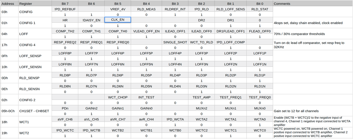

    I cannot provide schematics but here is our register table.

    /DRDY is only connected to ADS1298, it is not used in our design as both devices are synchronised with START (or should be)
    We can measure a reference at the ADS1298 but can measure no potential difference between the VREFP VREFN pins of the ADS1294. (This seems concerning)
    We are accounting for the dead bit. Here is a logic analyzer trace of the SPI lines. We can see there is no data on the bus for the last device for the final clocking.
    I have attached all of these files, including zoomed plots as a zip.

    At first glance, the registers look fine. I'll revisit this if necessary.

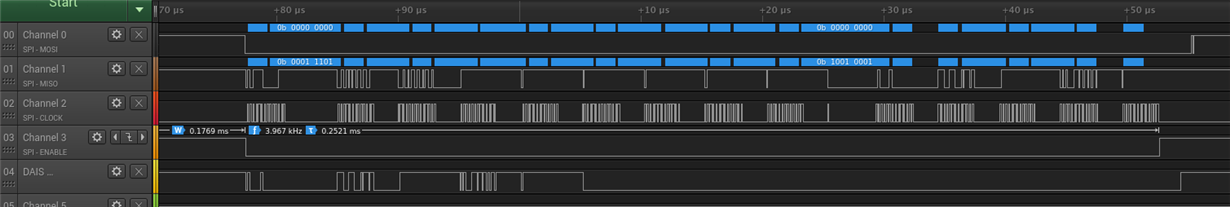

  • Hi Alex,
    My initial response is still in moderation but I had another question. Does the state of the internal reference depend on CLK_SEL at all? I can't figure out why the internal supplies are reading OK except the reference.
    Here are some more plots of our SPI transfers. You can see that DAISY_IN in quiet for the entire transfer.
    However, around every 16 transfer cycles we get a small burst of data that probably is noise or something but it does get carried through to DOUT through the ADS1298.
