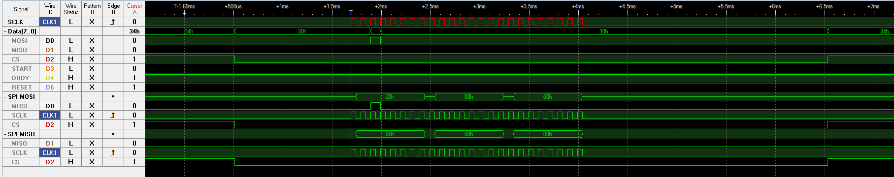

I've a problem with reading registers, for example ID-Register. I always get 0x00.   I can send the correct SPI (MOSI) commands to read the ID register, but MISO doesn't move. I've tried a lot of things the last weeks, but nothing seems to work. I'm really desperated and I hope someone can help me to fix the problem.
I use the ADS1298 Evaluation Module and the PSoC 6 BLE Pioneer Kit.
My SPI Settings: SCLK = 160 kHz, MSB first, CHPA = 1, CPOL = 0
My pin connections:
My SPI communication:
My code-functions:
/* This function sends a command */
void send_command(uint8_t cmd)
Cy_GPIO_Clr(AFE_CS_PORT, AFE_CS_NUM); // CS LOW
CyDelay(1);
AFE_SPIM_Write(cmd);
CyDelay(2);
Cy_GPIO_Set(AFE_CS_PORT, AFE_CS_NUM); // CS HIGH
/* This function reads out register value */
int read_byte(uint8_t reg_addr)
CyDelay(1);
AFE_SPIM_Write(0x20|reg_addr); // First Byte RREG, OPCODE 1;
AFE_SPIM_Write(0x00); // Second Byte RREG, OPCODE 2 --> number of registers to be read = 1
out1 = AFE_SPIM_Read();
CyDelay(5);
return(out1);
