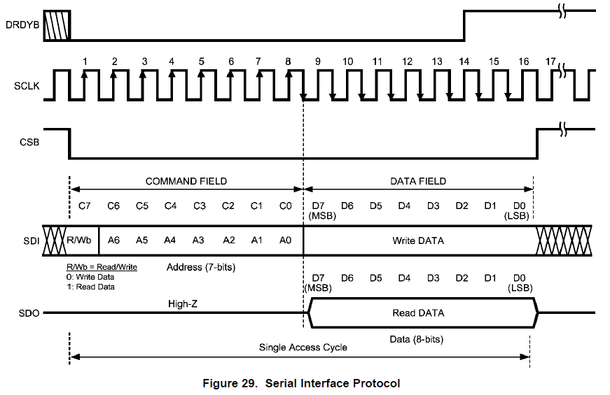

I have hard time using an auto-increment feature for reading ECG registers. If I specify to read 3 registers for one channel, I get correct data, but if I specify to read 9 registers, I get proper data for the channel 1 and random-ish noise on channels 2 and 3.
If I make three separate calls to read 3 bytes from 0x37, 0x3A and 0x3D, I get correct data for every channel.
I have tried configuring output of 3 ECG channels via DATA_LOOP register, but the result is the same - values are correct for the first channel and bogus for channels 2 and 3.
Do I have to configure the chip in some special way to make this feature work? Do I have a buggy revision of the chip? My configuration is as follows:

    Could you provide more details about the bogus data that you are reading? How are the analog inputs configured and how do you know the data is invalid?
    When using the auto-increment feature, you only need to specify the R/W bit and the starting address in the command field, followed by enough SCLKs to read from all the registers that you require. /CS can remain low throughout the register read.
    Keep in mind that the entire SPI operation must be completed before the next /DRDY (which appears to be driven by ECG_CH3 at 1.067 kSPS in your setup).
    Can you tell us what your SCLK frequency is? Also, it might help if you could share a capture of your SPI transaction with /DRDY, SCLK, /CS, and DOUT.

    I believe I am capturing at 100 samples per second - seems to be enough time to transfer 9 bytes.

    Regarding my problem - it is solved right now as I have noticed an error in my code - NRF spi driver puts input read during transfer of the command byte into response, I was interpreting it as the first byte of my data. After fixing this issue I am receiving data properly. Thanks for your help again.
