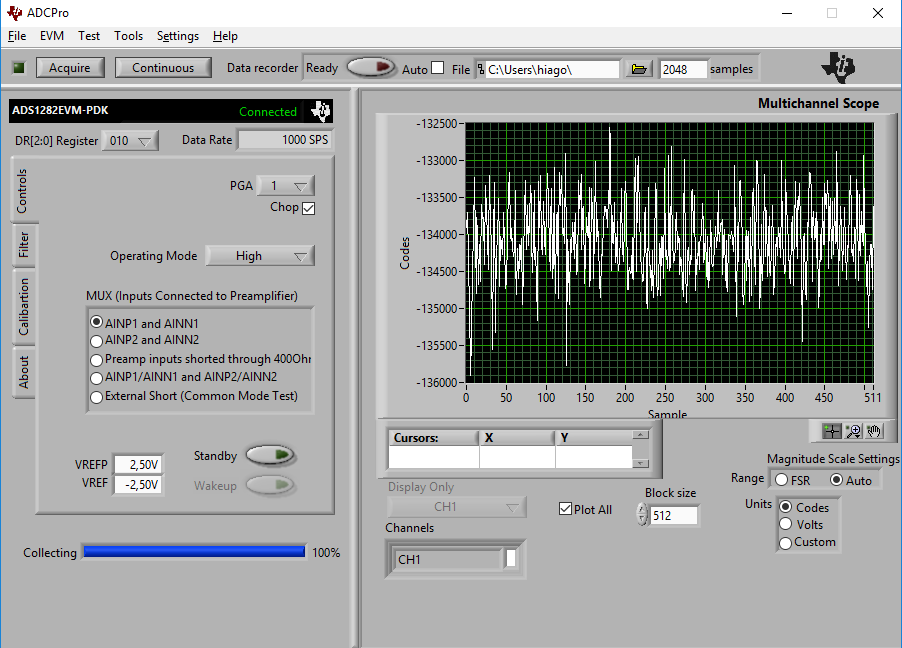

  • Hi Chris,
    Here is the ADC output signal when I send a continuous sinusoidal signal of 2Vpp (-1V to +1V) using the function generator with the board in the bipolar mode:
    Here is the ADC output signal when I turned off the function generator without unplugging the terminals:
    Here is the ADC output signal when I unplugged the terminals, making the ADC channels float:
    A picture showing the connections between the function generator and the board:
    A picture showing the connections between the board and the power supplies (the second power supply is used for the -5V and the GND of both of them are connected):
    All the jumper connections in the board are default from the factory, except J12 that was unplugged in order to supply via J14. The switches are also in their default position from the factory.
    I am really lost here, I hope you can help me set this board in the bipolar mode.
    Thank you in advance,
    Hiago

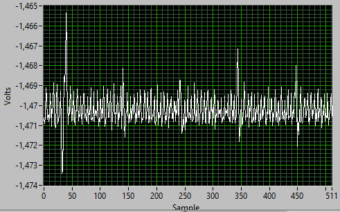

  • Another question, after testing the board on the unipolar mode with a constant negative signal, the results matched with the sent signal. Does that mean that even in the unipolar mode the ADC can work with both positive and negative voltage? Is the voltage reference always +2,5V and -2.5V? What's the difference between unipolar and bipolar mode?
    The following picture shows the output of the ADC in unipolar mode with a -1.4V signal.
    I'm a kinda lost here, i hope you can help me.
    Thank you again,
    Hiago.
    I discovered that the problem I had with the readings was the signal generator's plugin. After changing it I was able to read the data from the ads1282.
    I still don't understand the difference between unipolar and bipolar mode in the evaluation board. The ads1282 reads +2,5v and -2,5v both in the unipolar and bipolar mode. I thought it could only read negative voltage on the bipolar mode. Can you help me understand the difference between these two modes?
    Hiago
