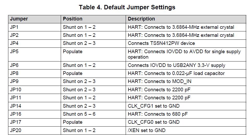

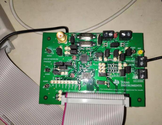

There are many jumpers in DAC8742HEVM. Could you pls provide a checklist about how to configure it to SPI Interfaced FOUNDATION FIELDBUS / PROFIBUS PA mode?

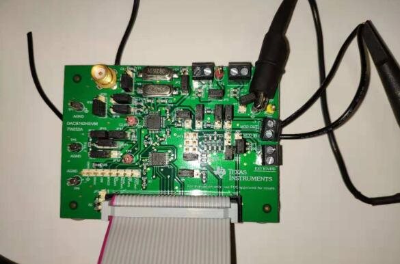

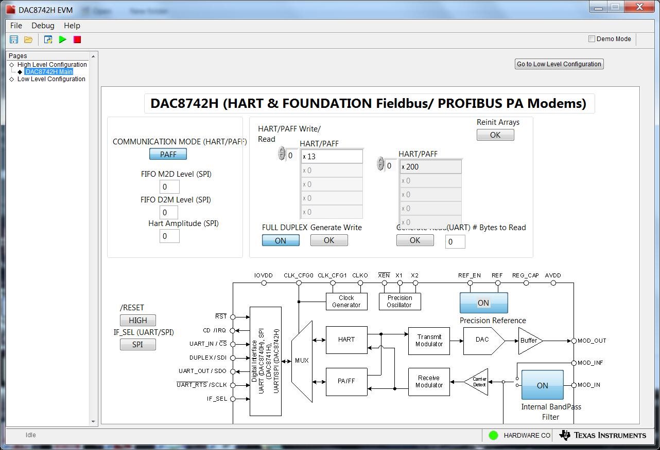

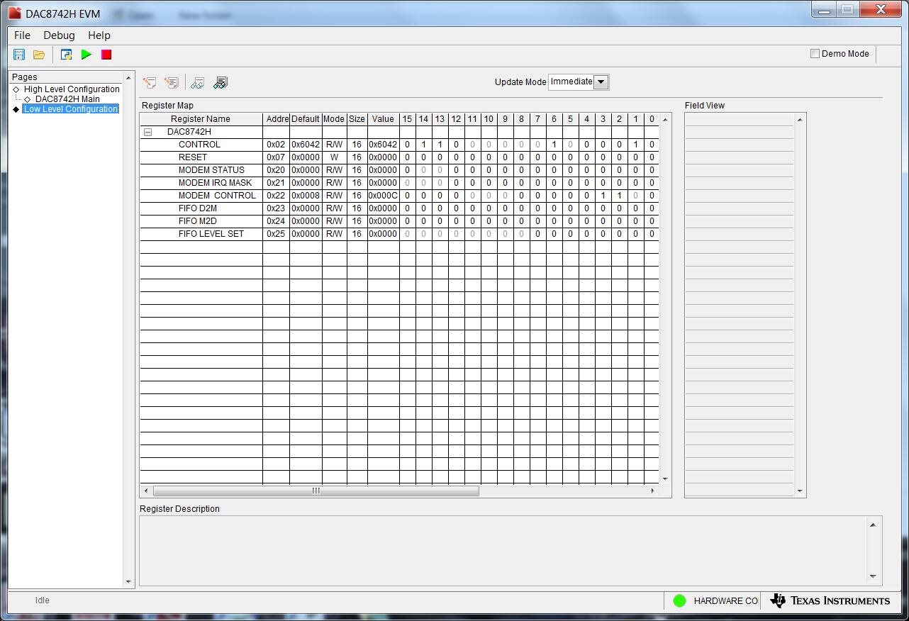

I tried to configure it by EVM User Guide, and generate data by Hart/PAFF Write in GUI. I measured signal on MOD_OUT with oscilloscope, but I'm not sure if it transmits the correct data. Could you show me a simple way to confirm it?

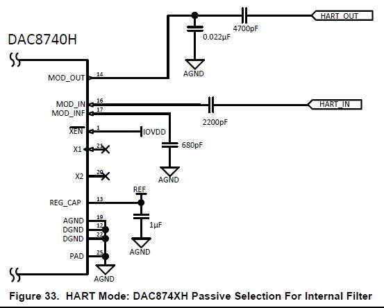

I would like to build a small network with two EVMs as below shows. Do you think it will work?
