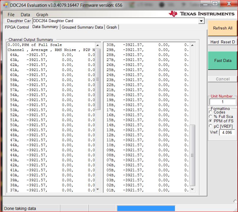

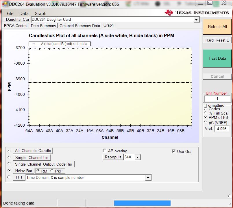

  • It now LOOKS like it is communicating (it says Refreshed when you hit Refresh All), but the data is bogus and un-responsive. All channels read -3921.57, with or without the analog voltage applied. RMS noise all channels is 0.00. All LED's are on, it has a program and is connected to USB

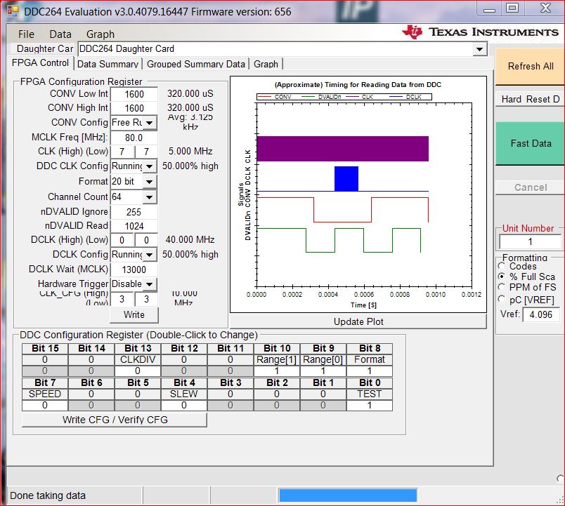

  • Hi David,
    For testing DDC264EVM, please try the following example:
    Hope you can see very similar result:
    1) Please set the FPGA Control:
    First, you can choose "Channel Count" to be 64 (only one DDC264 device=64 channels).
    Later you can change it to be 256 (totally 4 DDC264 devices=256 channels)
    2) Please select Noise measurement with Graph:
    Thank you for using DDC264EVM.
    Chen
  • I did as you suggested. No change, I still get -3921.57 on all channels.
  • Hi David,
    How are you?
    Could you please provide us your pictures (plots)
    you received when you ran the DDC264 GUI?
    Thank you!
    Chen

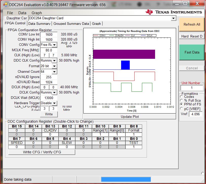

  • Hi David,
    How are you?
    Thanks for the pictures.
    When you get all the same data (for example: -3921.57) on all channels,
    that means DDC264EVM's output data are not correct.
    1) on the DDC264EVM, please press the following buttons:
    S1: REST
    S2: RST FPGA
    2) Please check on your EVM for the following jumpers:
    J19: JACK and 5V are connected
    J22: must be shorted
    J20: must be shorted
    3) the power connector (black) J18 must be connected to 5V dc.
    4) J12 and J5 are NOT used.
    5) please double check: J1 (USB connector) is connected to your PC.
    6) Please make sure: each time when you are using DDC264 GUI,
    after you click on "Write" button and "Write CFG/Verify CFG" button,
    then please must click on "Refresh All" button
    and finally click on "Fast Data" button.
    When click on each button, please wait until it is done
    and then you can continue to click on next button.
    Also when DDC264 GUI is running,
    please don't click on other GUI button
    until GUI displays "Done".
    Hopefully everything is working fine.
    Thank you!
    Chen

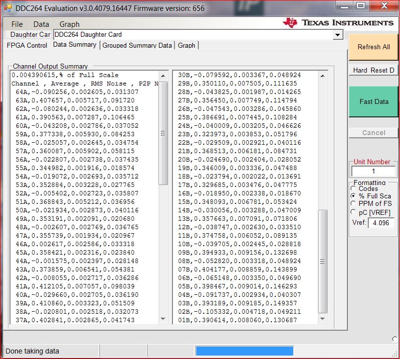

  • Yes - that's how it's connected and yes all the LED's are lit. I get new data each time I press Fast Data but it doesn't seem to matter what voltage I have. It always seems to stay right around .38% FS. One time it went up to 0.4% when I had 2V input, but then it went back down to .38% when I went to 3V and never changed again.

  • Hi David,
    How are you?
    First, we checked all three Jumpers:
    J19: shunt both Jack and 5V
    J22: shunt
    J20: shunt
    Secondly,
    We connect 5V power connector to J18
    Also, Yes, we followed your first plot with all the same settings as you did.
    After that, we did the followings:
    1) Click on "Write" button (white button)
    2) Click on "Write CFG/Verify CFG" button (white button)
    3) Click on "Refresh All" button (yellow button)
    then, 4) Click on "Fast Data" button (green button)
    After that,
    We checked the following two test results:
    To compare to the previous plots you sent to us:
    These two plots you can see are very similar to the results shown on the DDC264 User's Guide.
    Hope you can observe the similar test results.
    Thank you!
