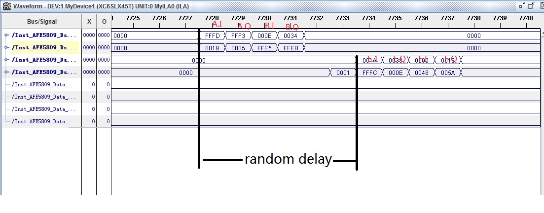

   I have found a very strange behavior of my custom AFE5809 board.
  The ADC_clk is 20MHz, decimation factor M=32, output bit number is 16. Moudle bypass =  0, output channel select = 0 , full LVDS = 0, so that A.I, A.Q, B.I  and B.Q will come out on lane 1 sucessively, followed by 28 padded zeros. I will only have to retrieve data on lane 1/3/5/7 for all the 8 channels.
   To my through, these 4 lanes should be all  syncronized to FCLK, but actually it is not in my case. Please see Figure 1. Although lane1 and lane 3 are syncronized, there is a random delay between lane 5/7 and lane 1/3. When I say "random", I mean the delay is different after every system reset, but will not change after then.
Figure 1 : data on the 4 lanes after serial to parell transorming, sample clk = 20MHz
To make sure whether this delay is introduced by my FPGA logic, or by 5809 it self, I then observed the data before serial to parell transorming, which is shown in Figure 2, and is in consistence with Figure 1. so I guess the delay is from 5809.
Figure 2 data on 4 lanes before serial to parell transforming. sample clk=80MHz (under sampled, but ok for demonstrating)
The problem is how dose this delay come? this makes the FCLK meaningless. What should I do to avoid such delay? Thank you!

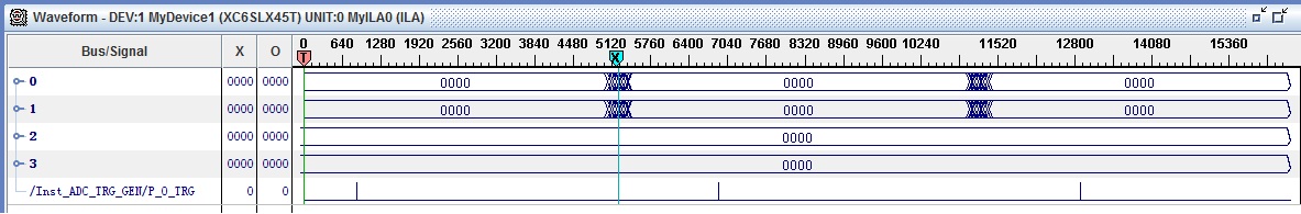

  • updates:
         I guess this issue has someting to do with the external hardware TRG signal. As LVDS lane1/3 are from Demod Subchip 0 while lane 5/7 are from Demod Subchip 1, they might not be syncronized after reset. However, when I tried to put a external trg signal to AFE5809, someting more interesting happens, please see Figure 3.
    1. data on lane 5/7 all become zeros
    2. there are only 8 samples one lane1/3, after each trigger
    3. the inserted head (0X"2772") is more than 4000 clks latter than the trigger signal.
    All these will not happen if I don't feed external trigger signal to 5809. when should the external trg signal be on the TRG pin?
    Figure 3 : sampled data (clk = 20MHz) on lane 1/3/5/7, and external trigger signal

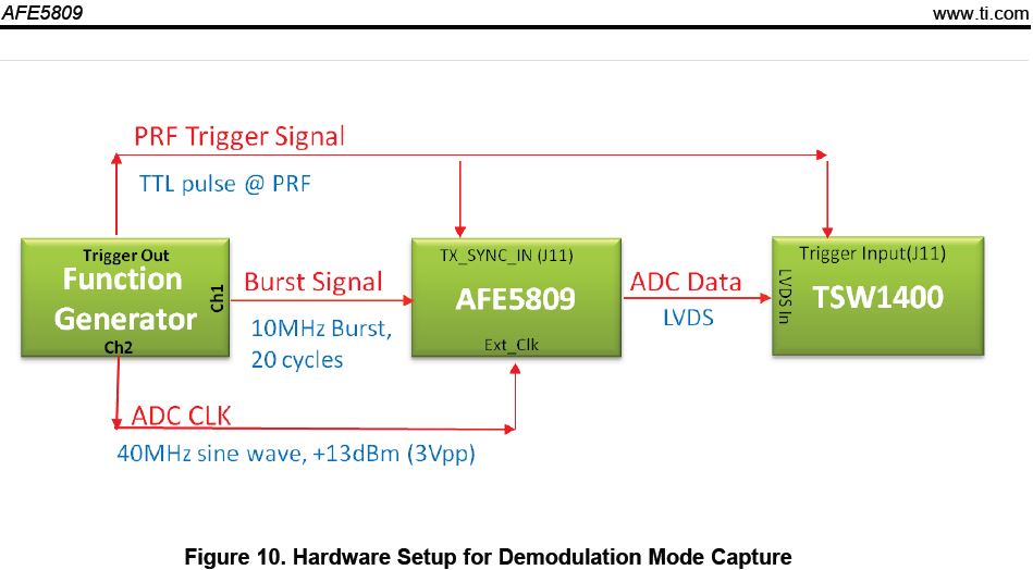

  • Hi Feng,
    How are you?
    Thanks for using AFE5809 device.
    Please take a look the following from AFE5809 User's Guide
    for when running AFE5809 Demode mode hardware setup:
    Thank you very much!
    Have a nice day!
    Chen
  • Hi Feng,
    Therefore the TX_SYNC_IN input pin needs to be triggered
    to synchronize all the output channels.
    That is very important.
    Chen
