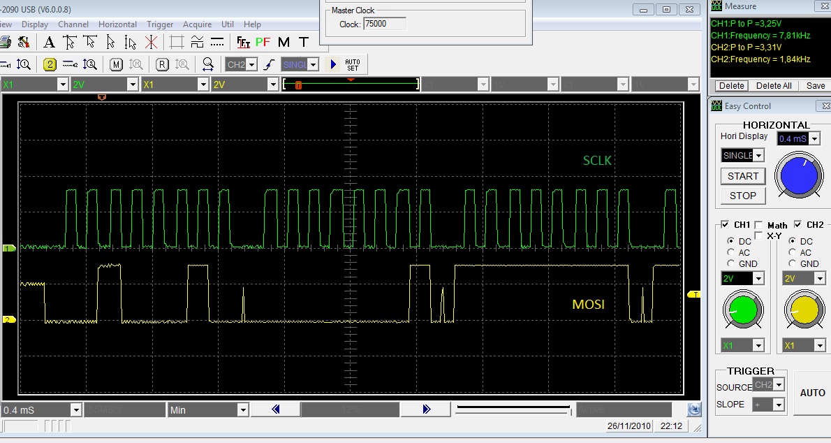

Hello, I'm having trouble to communicate with the ADS1247.
I'm trying to read the registers but is not working.
I'm managing only lines SCK, MISO and MOSI, line START I always leave on a high level and line level in CS always let down.
With the oscilloscope looked at the waveforms, and signals CLK and MOSI seem to agree, but I'm not getting the ADS1247 useful information.
I am using ARM LPC1343, and the following code in C:
i2c_buff [0] = 0x20;
i2c_buff [1] = 0x03;
i2c_buff [2] = 0xFF;
i2c_buff [3] = 0xFF;
i2c_buff [4] = 0xFF;
i2c_buff [5] = 0xFF;
lpc1xxx_ssp_send (i2c_buff, 6);
lpc1xxx_ssp_receive (i2c_buff, 4);
I load the data into a buffer and sent to the function ssp.

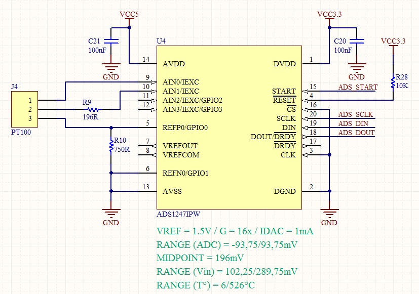

  • Hi styg,
    Could you perhaps include the schematic around your ADS1247 and maybe screen shots of your SPI interface?  The code snippet seems fine.

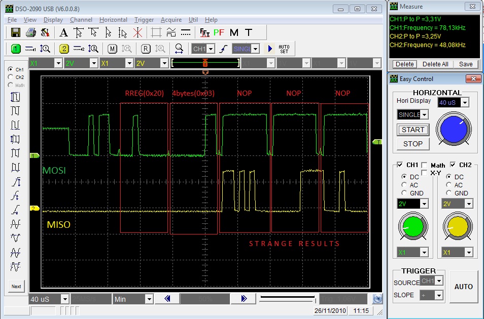

  • It is true the word to write in the reg was wrong, now remade the code taking into account their suggestions.
    i2c_buff [0] = 0x16 / / SDATAC
    lpc1xxx_delay_ms (1);
    i2c_buff [0] = 0x20 / / Streams
    It seems that things have improved a little, but I'm not sure yet reading.
    I am testing only reading, and it is giving problem. After running the above code, my buffer contains the values:
    i2c_buff = {0x00, 0x01, 0x00, 0x20}
    But according to the datasheet should be:
    i2c_buff = {0x01, 0x00, 0x00, 0x00}
    A doubt, the values of these registers return to default value to each reset, correct?
  • bytes sended by lpc1343
  • These waveforms are the MOSI and MISO lines, making the reading of four REGs after RESET (without writing the REGs), and disabling DATACAR.
    My oscilloscope only has two channels so it's pretty limited.

  • Styg,
    Thanks for all the pictures.  As per datasheet  page 51, "The SDATAC command takes effect after the next DRDY."  I think what you are seeing is data in the output register.  Try a delay between the SDATAC command and the read register command to make sure that the SDATAC command has been activated.
    Bob B

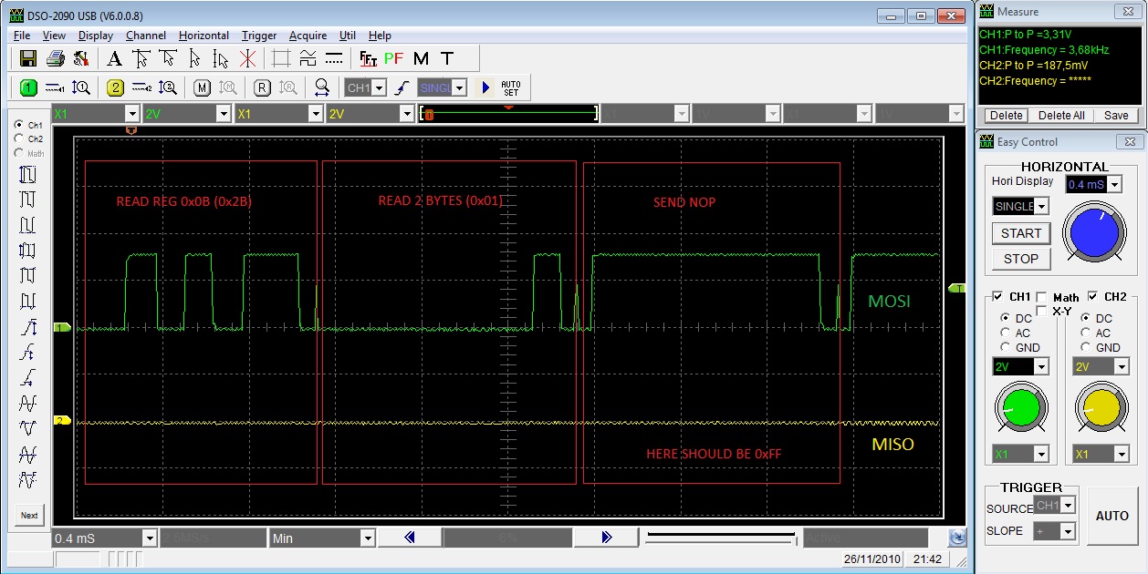

  • Yeah, actually I had done that but still does not work (delay 1ms).
    It seems that my problem is similar to the other post I saw here in the forum, because usually what I'm getting the ADS is 0x00.
    I have some questions:
    1) The NOP command must be sent only when reading from a register or data, right? NOP does not need to send another time.
    2) The START line, if high level sends data continuously, but at a low level, goes into sleep? What to do with it?
    3) The CS line, I need to keep changing? Or I can leave at a low level?
    4) How should be set CPOL and CPHA bits of the SPI bus?
    5) What is the maximum frequency of the CLK?
  • Styg,
    A 1ms delay is not long enough.  Default data rate is 5sps, so you need at least 200ms before the SDATAC is completed.
    1) A NOP command is needed as the SPI is full duplex, so any time you are actually getting data you should send the NOP.
    2) When the START pin is low, the analog portion of the part is asleep.  You will need to pull the START pin high if you want the device to start converting.  The digital portion is still active when the analog portion is asleep.
    3) You can leave CS low if this is the only device in your system that is SPI.
    4&5) See the timing diagram Figure 1 on page 10 of the datasheet.  Maximum SCLK frequency is minimum period of 500ns (2MHZ).  SCLK idles low, data is shifted into DIN on the falling edge of SCLK and shifted out of DOUN on the falling edge of SCLK.
    Bob B

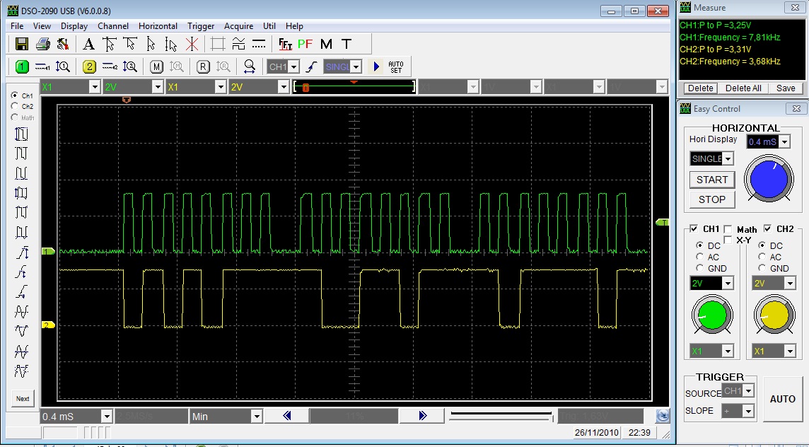

  • Now I noticed that the time that I have to wait after sending the command SDATAC has to be greater than 200ms (because the default sample rate is 5SPS), so now I'm using 300ms of delay.
    CPHA and CPOL am using = 0.
    Waveforms attempt to read the reg IDAC1 (Default 0xFF).
  • Styg,
    The problem with two channel scopes is that you can't see everything at once.  Can you resubmit a plot of the SCLK and MOSI just so we can verify the timing?
    Bob B
  • Styg,
    Notice that the edges have shifted from what you had previously.  The ADS124x reads the data on the falling edge, so you should see a solid high at the third clock high to low transition for example.
    Bob B

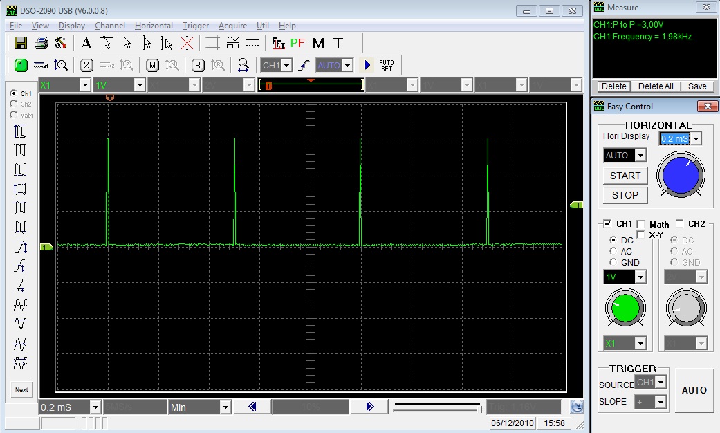

  • Look, it is really difficult to talk to this ADS1247!
    Now I'm controlling / verifying also the lines DRDY, and START
    Now I did a test to see if I really am writing in REGs, writing in the reg to change the sampling rate.
    The configuration I do is this:
    LPC_GPIO2-> DATA | = (1 <<ADS_START) / / START HIGH
    i2c_buff [0] = 0x16;
    lpc1xxx_ssp_send (i2c_buff, 1); / / SEND SDATAC
    lpc1xxx_delay_ms (500) / / WAIT FOR DRDY
    / / Send command WREG (0x40) to write the first 4 control regs
    i2c_buff [0] = 0x40;
    i2c_buff [2] = 0x01 / / MUX0 (current off burnout, in = AIN0, in-AIN1 =)
    i2c_buff [3] = 0x00 / / Vbias (no bias voltage applied)
    i2c_buff [4] = 0x33 / / MUX1 (int osc.. ref. int. on, ref0, diode)
    i2c_buff [5] = 0x4F, / / sys0 (16x gain, 2000SPS)
    / / Send command WREG (0x40) to write the regs and IDAC0 IDAC1
    i2c_buff [0] = 0x4A;
    i2c_buff [1] = 0x01;
    i2c_buff [2] = 0x06 / / IDAC0 (DRDY and DOUT separated, I = 1mA)
    i2c_buff [3] = 0x01 / / IDAC1 (current at the entrances and AIN0 AIN1)
    lpc1xxx_ssp_send (i2c_buff, 4);
    LPC_GPIO2-> DATA & = ~ (1 <<ADS_START) / / START LOW
    With this startup, I can see on the oscilloscope sampling rate actually moved to 2000sps (picture)

    And a question, why the DRDY signal (picture) looks like it was inverted?
  • Styg,
    If there isn't a challenge where would the fun be?  Or sense of accomplishment?
    One thing that I neglected to tell you in the last post is the output code is binary two's complement.  That means that 'read' (which is still defined as 'reading' in your code and you need to fix it) should be a signed value.  You will need to sign extend the 24 bit value to 32bit (?) so that the sign shows the proper value for the code represented.
    I'm a little confused as to how your code works for read/write.  If you send the RDATA command the next 24 SCLKS will output the data, but it appears that you send 24 clocks of writing data first.  Then send another 24 SCLKS to read.  I think you will need to adapt your code so that the reading of registers is correct, or in this case the reading of the conversion data.
    You also asked about the waveform.  This is what it looks like if the data is not read.  DRDY goes high after the first SCLK.
    Bob B

  • Forgot to put in the datasheet VREFCOM have to be connected to earth, so that the internal reference works!
    Now I'm able to read some values of the internal temperature sensor, but is very varied, the saga continues.
  • Styg,
    Yes, VREFCOM should be connected to ground, and you must also have a capacitor between VREFOUT and VREFCOM.  Please review page 29 of the datasheet where it discusses this within the section titled Internal Voltage Reference.
    Best regards
  • Thanks Bob, really that's what was missing, with the capacitor, the variation in reading the internal temperature decreased significantly.
