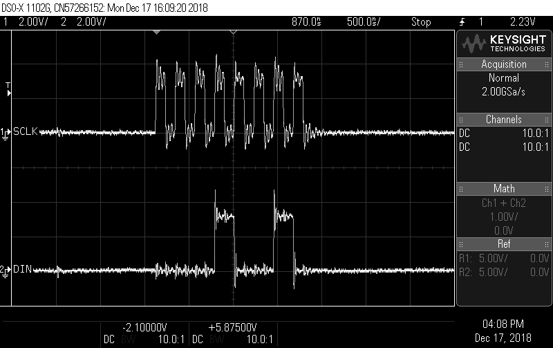

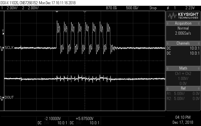

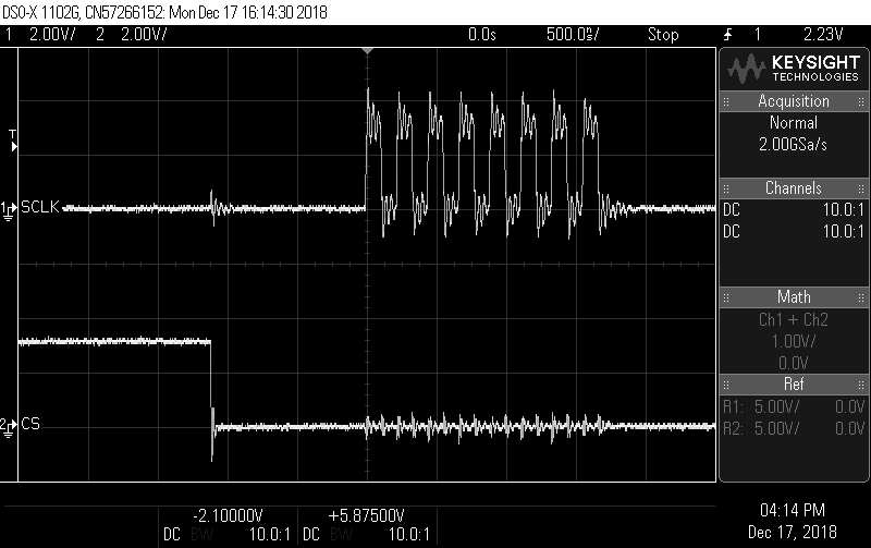

    Sorry for the delay. I have attached the screenshots of sclk vs din, sclk vs dout, sclk vs cs. Awaiting your response

  • Hi Roobini,
    Thank you for sending over some oscilloscope screenshots!
    From the screenshots it looks like there is a lot of ringing on the SPI signals. It is quite possible that this could be interfering with the ADC communication. Do you have the ability to add some series resistors (or shunt capacitors) to these signal traces to help slow down the fast digital edges and hopefully remove the ringing?
    Also may I ask what your ADC master clock frequency is?
    According to the ADS1256 datasheet, the master clock rate should be between 0.1 and 10 MHz (7.68 MHz nominal to get the specified data rates). Also, note that the SCLK frequency must not exceed 1/4 of the master clock frequency. For example, if the master clock frequency is 7.68 MHz, then the SCLK frequency should be no more than 7.68 MHz / 4 = 1.92 MHz. The 4.5 MHz SCLK is a bit fast, so please try reducing the frequency of this clock as well.

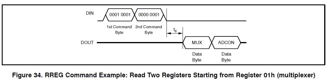

  • Hi Roobini,
    Indeed, it looks like you are getting multiple junk bytes before seeing the valid register data. You should be getting the register data in the 3rd DOUT byte, as shown in figure 34 of the datasheet:

    3. Double check on the t3 (time between /CS low and the first rising edge of SCLK) and t6 (time between command byte and register data byte, as shown above) timing requirements.  If there is not a sufficient delay in these places you may read invalid data.
