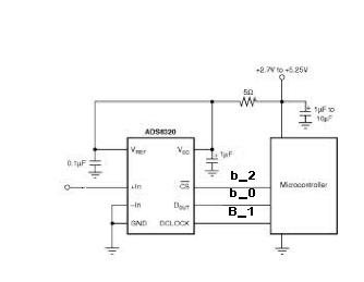

    thanks for your reply.
    My CIRCUIT is simple. very similar to Figure 8 in the ADS8320 datasheet(
    with a low-pass filter formed with a 47uF capacitor and a resistance of 100 ohm)

  • Hi Manuel,
    In the ADS8320 datasheet you will see a delay time (tSUCS on page 10) that describes the time from the falling /CS to the first rising SCLK.  Change your code so that the SCLK dwells low while it is inactive.  Next, the sixth SCLK from the falling /CS is a 'null' bit - the device will output a zero while the MSB id being converted, so change your first loop to be   for(i=0;i<=6;i++).  The rest looks OK to me.

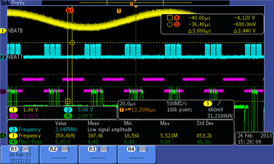

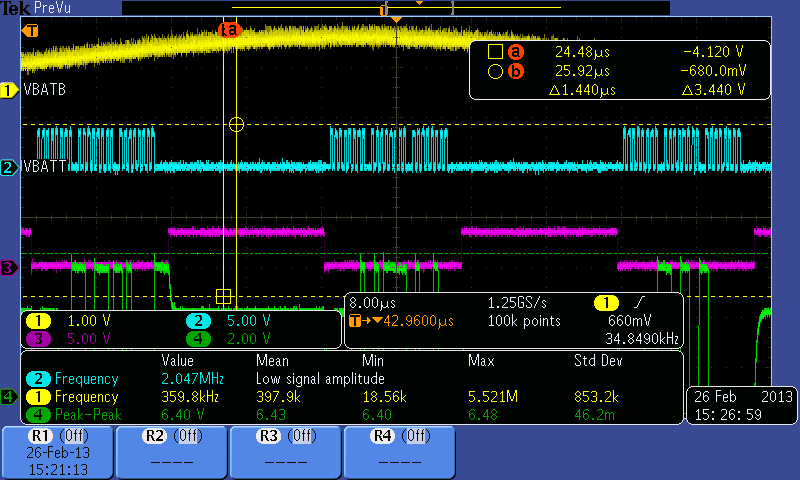

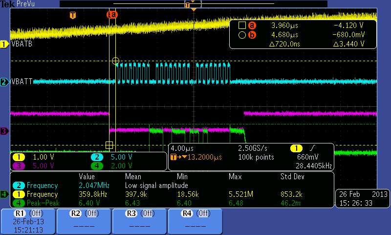

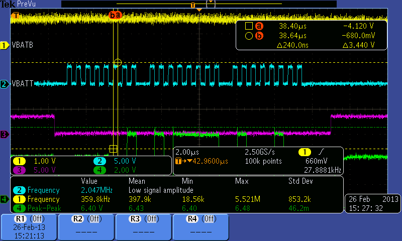

  • - I am sampling a sine signal that generated from a functional generator. It is a 8KHz sine signal and I am sampling at 32Khz. Thus, I am getting 4 ADC value per period
    - I am using a 3v reference voltage.
    - Here are a few screen shot. Yellow is input signal (8KHz sine at 0.426V amplitude and 0.3V offset), Blue is SCLK, pink is /CS, and green is SDO. The ADC's VCC is 5V but I am interface the SPI bus to a processor that with 3.3V VCC. I don't think the 5V as VCC for the ADC should be a concern because I previous use the same 3.3v as VCC for the ADC and it behave the same.
    - the SPI clock is running at 2.048MHz and I am sampling the ADC data using a DMA engine to generate 3 burst of 8 bit SPI clocks.

  • Hi Zhenyu,
    From the last plot in your post, the ADC seems to be converting just fine. The output word (green trace) being read out is 0x57D1 or 22481 decimal. With a 3V reference, this translates to a corresponding input voltage of 22481*3V/65536 ~= 1.03V. Now, the signal on the yellow trace is noisy, but we can see that the input is at about 1div * 1V/div = 1V, which is pretty close to what we expect. So the ADC appears to be working as it should.
    I see that you have a long delay between ADC conversions as a result of which you are only able to sample the input 4 times per period, instead of 10 times per period, considering your nearly 85KHz conversion cycle (2.048MHz/24). To this end I would recommend reducing the duty cycle of the /CS signal to <5% if possible so that the /CS high phase is minimized to just 1 or 2 cycles.
    Harsha
  • Hello there,
             The main reason that we are using a 16bit ADC is to get a more accurate reading data and that is why the previous user and I try to point out that this ADC doesn't return ADC reading accurately as we are expecting. Like you also point out, the input signal is quite noise; thus, I expect the reading from ADC should reflect the noise signal. The last 2-3 bits of reading should be fluctuated in reflecting of noise signal but the reading did not show that. As shown in my data file, most of them it is the 3rd or 4th LSB change value. Effectively, I am getting a 12-13bit ADC accuracy instead of 16 bit that i am hoping for. If this is expected like you mentioned, I think I will need to look for alternative solution.
  • Zhenyu,
    Thank you for the clarification. Sorry I misinterpreted your comments.
    I sorted the data you provided by code and now I understand what you mean by "discrete" ADC outputs. As you have pointed out, the ADS8320 is a 16-bit ADC and the output data should exhibit much more variation for the amount of noise there is on the input signal. The part seems to be showing significant degradation in DNL, which is reducing the resolution of the ADC.
    The loss of resolution is often due to gross variations in reference voltage during conversion. On SAR converters the input impedance of the reference input is dynamic and it changes during conversion. Ideally, a good reference circuit will ensure that the voltage at the reference pin changes by less than 1LSB while the ADC is converting. It would be helpful if you could send me a scope capture of the voltage at the reference pin over 2 or 3 periods of your input signal, as the ADC is converting. I understand that a few LSBs of variation is too small for most oscilloscopes to resolve but any gross problems should show up. If possible could you also send me your schematic showing your reference circuit?
