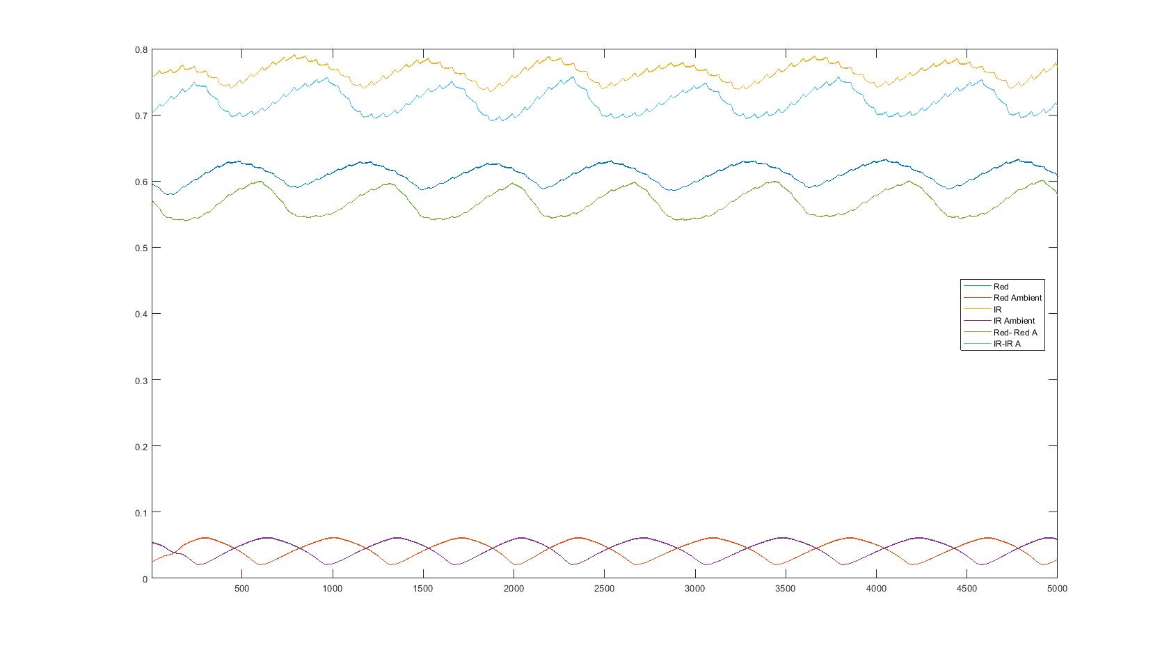

Deal all,
I measured PPG signals but they tend to follow sinewave. I used PRF of 100 Hz and current of 1.76 mA. I would like to know the reason of signals drifted. Thank you.
  • Hi Yee,
    Since the sine wave is present even in the ambient phases, I strongly believe that is the due to the ambient light. I would suggest to try to cover the sensor properly to block the ambient light or it can be removed in MCU by passing it through HPF.
    Prabin
