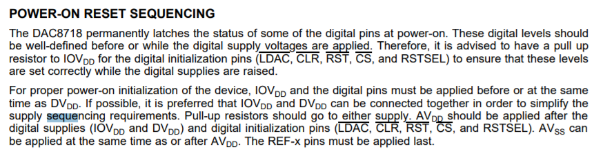

Hello E2E,
Our customer is testing a new circuit board. The board is using DAC8718.
The output mode changes according to the power supply sequence.
· AVDD → REF-A / REF-B → AVSS → DVDD · IOVDD
⇒ Unipolar
· DVDD · IOVDD → AVDD → REF-A / REF-B → AVSS
⇒ Bipolar
Question;
- Does DAC8718 have regulation for power-up sequence?
- Please let us know how to set the output mode correctly?
