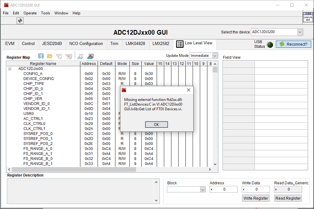

  • GUI, I get the following error message. When plugging into the board, the LEDs come on, but the GUI cannot connect to the EVM. (hence the lack of green "USB connected" light in the GUI).
    Any ideas on where I could find the missing ftd2xx.dll file?

  • Hi Justen
    Sorry for the delay. That file would normally be included with the High Speed Data Converter Pro software installation.
    If don't need HSDC Pro you can install it using the FTDI D2XX driver installation which is available from their page here:
    https://www.ftdichip.com/Drivers/D2XX.htm
    I hope this is helpful.
