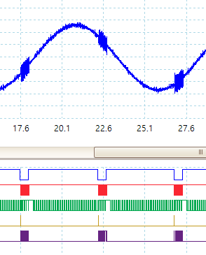

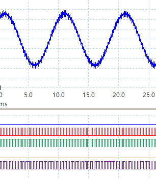

  • I use ADS1299EEGFE-PDK board and ADS1299EEGFE-PDK application program
    this osiloscop picture is also picture of ads1299EEGFE-PDK application program
    But all I want is Receving the above data(many samples at a time) on other devices like raspberry pies.  like a ads1299EEGFE-PDK application
    and only use raspberry pi and ads1299EEGFE board without ads1299EEGFE-PDK
    Is it impossible without ADS1299EEGFE-PDK??
  • Hi Keunsoo,
    I apologize, I did not understand the question initially.
    What I think you're asking about is how to receive data continuously as opposed to one sample at a time. Correct?
    You want to do this without using the MMB0 motheboard, and use a Raspberrypi instead. Correct?
    Please review section 9.5 of the ADS1299 datasheet. Especially 9.5.3.7, RDATAC: Read Data Continuous.
    These threads should help as well: e2e.ti.com/.../2190119
    e2e.ti.com/.../346609
    e2e.ti.com/.../452144
