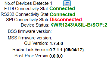

    It appears that you are using a very old version of Radar Studio.
    Could you please let us know the device version (the "Device Status" field in Radar Studio)?
    Anand
  • Hi Anand,
    Thanks for the response. I am AWR1243BOOST and I have enclosed the Device Status field in my original post. My Radar Studio version is 0007004. We bought this board before May 2017.

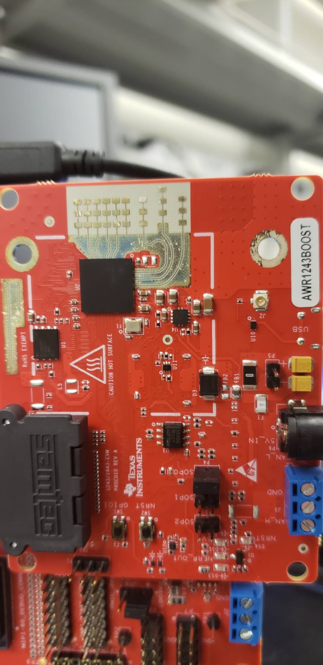

    Also, can you please paste a picture of the top side of the AWR1243 BOOST here? We want to try to identify the version of the board and device.
    Anand
  • Hi Anand,
    Thanks for your response. I tried the DFP 00.09.01.06 version and the problem is the same. The radarStudio could not find the postproc and the error is the same as the original post.
    Also I upload the picture for our board.
    We cannot identify the chip revision from this photo as the markings are not clear. Could you post a screenshot from RadarStudio from DFP 00.09.01.06. Please post the complete screenshot for the Device Status section, and also the log file. You can get the log file by Right Clicking in the Output window and selecting "Show Log File" or "Open Log Folder".

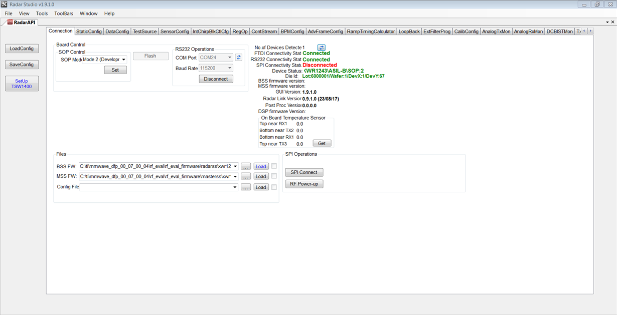

    Also, I enclosed the information for RadarStudio
