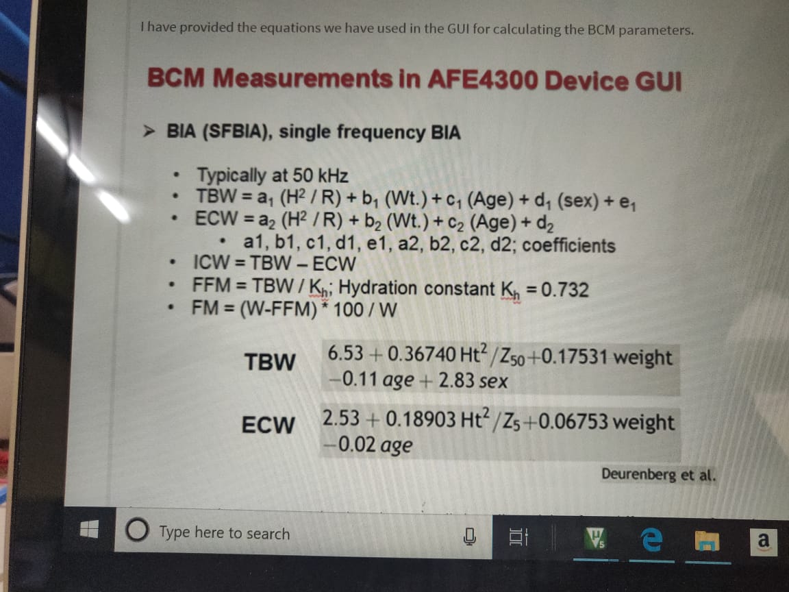

I had a few doubts regarding the formula for BCM calculation as suggested in TIe2e in another thread. I have attached a photo of the same.
As it can be seen there is a formula for Total Body Water in which we substitute values of height value. In what units should the height value be substituted?
Also in the ecw formula it is given we should substitute Z5. Does this mean we have calculate it at 5khz frequency? or is it 50 only?
