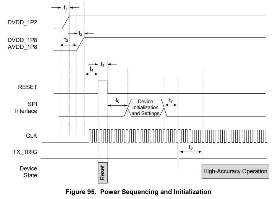

My customer is evaluating ADS52J90 on their pre-production.
They use multiple ADS52J90 chips and try to synchronize chips.
However, synchronization error sometimes occur at about 0℃, and it improves when below t4~t8 become longer than typical condition(they are 10 times of min value).
Though t4~t8 seem to be related to chip synchronization, is it correct understanding?
If no, why is synchronization error improved by changing power sequence?
We would like to know if changing power sequence is correct as workaround of synchronization error.

  • Hi Kuramochi-san,
    How are you?
    For ADS52J90 running at cold temp,
    we suggest:
    1) Write the register Address=0x0A  Data=0x3000 for Initialization (Table 43 of the data sheet)
    2) Also please try to increase t5 (the width of RESET pulse).
    Thank you for helping the customer.
    Chen

    For the question #1:
    Right now we don't know where is the problem coming from yet,
    we suspect at Low temp test for the timing of RESET
    the device may need to take longer time to reset the whole system inside the unit.
    So far we just suggest the customer to try it and see if it could help the issue
    and don't have any conclusion yet.

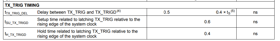

    For the question #2:
    As long as both the system clock and TX_TRIG input into multiple chips at the same time
    by following the data sheet spec. condition (requiring: min=0.5ns ~ max=0.4*ts),
    they should be able to be synchronized
    However for running at Low temp, if this condition becomes different.
    then Sorry, please let me contact with the design team to double check on this?
    Thank you!
    For the question #3:
    No, the falling edge of TX_TRIG does not take any action of synchronization.

    For the previous question #2:
    Our design team replied as below:
    They need to follow tTX_TRIG_DEL, tSU_TX_TRIGD, and tH_TX_TRIGD parameters to meet timing.
    It is valid across temperature.
    For your multiple TX_TRIG pulses:
    Only Trigger B (the latest) would be recognized.
    Thank you!

    About #2, I'm considering that TX_TRIG pulse should rise up during previous SYSCLK high term to synchronize each chip as below.
    Because sum of tTX_TRIG_DEL and tSU_TX_TRIGD is shorter than 1/2 cycle of SYS CLK, so conversion timing is not affected to these delay and should accord.

    Please take a look here is more detail explanation from our team system engineer:
    Thank you!
    The delay between TX_TRIGD" and TX_TRIG depends on
    when TRIG trig is applied, or ADC CLK freq is.
    The max is 0.4TCLK, so the TX_TRIG setup time
    would be 0.4TCLK+0.6ns minimal refer to
    the ADC rising edge of the CLK.
    Hold time min(=0.5ns) would be 0.5ns delay+0.4ns=0.9ns
    refer to the ADC rising edge.
    An easy to meet configuration would be
    • TX_TRIG: width= 1 ADC CLK cycle
    • TX_TRIG aligned with ADC CLK’s falling edge.
    • After the delay, worse delay is 0.4TCLK,
    so we still have 0.1CLK as the Setup time.
    for CLK as high as 80MHz, 0.1CLK=1.25ns is still enogh
    for 0.6ns setup time.
    • The shorted delay is 0.5ns.
    so the hold time is 0.5ns and still meet
    the 0.4ns hold time for H_TX_TRIGD.
