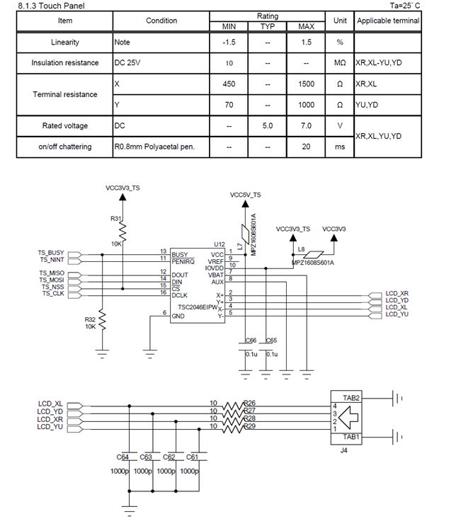

I will use TSC2046IPW for 7-inch, 4-wire resistive touch panel in my new project.
So, I would like to ask to review my schematic.
Please refer to following specs of touch panel and schematic and let me know your comment.
Thanks.
