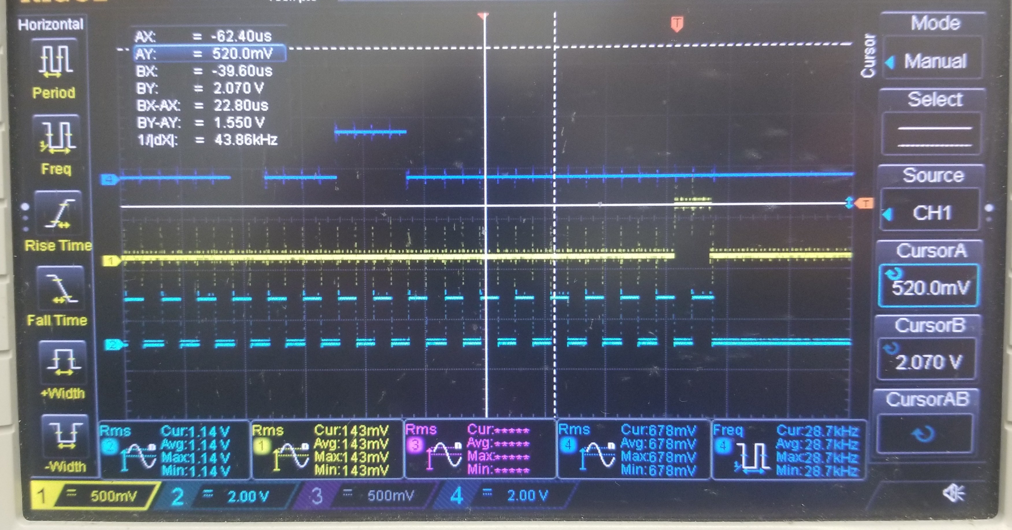

    However, I'm unable to use your commands to read from any of the digital registers. Additionally, my ADC only appears to be writing high to about 500mV. I've checked my supplies and they are all good, and nothing else is on the spi line to cause any issues. Is this something you've seen before?

    Thanks, I'm investigating this further. I've supplied the ADC clock, and wrote the proper digital reset bit, and I can now read and write to any register. I triggered sysref over spi via the method described in section 9.3.2.1.1 of the lmk04828 datasheet. However, I'm still having the 500mV issue.
    I know my power sequencing may be an issue right now (which I'm going to try and fix tomorrow). However, that should just effect the default registers correct? Or does that entirely wreck all known behavior?
    I'm pretty stuck on this read back right now, since it requires me manually decoding over a scope instead of with my logic analyzer

    What do you mean when you mention "  my ADC only appears to be writing high to about 500mV"? Are you referring to the digital output bits? The first thing I would do is to monitor the current drawn by the ADC. Power down ADC using SPI and verify the current drops. This will verify the SPI is working without using read back mode.
    Jim
  • Hi Jim,
    Yes, I mean the SPI MISO line is only being driven to 500mV instead of the 1.8V I expect. I powered down the ADC with SPI and watched my current drop by 400-500mA. I can trigger a read on SPI, and based on scope samples, it matches what I have programmed, but the amplitude of those readbacks is only 500mV.
    My clock rate is only about 80kHz on SPI, and I've tried adding different loading resistors to the line to check it's not a weird issue with termination. There is no change to the signal amplitudes.

    I assume you are referring to the SDOUT pin, correct? The level of this signal should typically be at DVDD. Is your DVDD supply at 1.9V? What are you driving with this signal?
    Jim
  • Hi Jim,
    I've figured out what the issue is, I just don't know how to solve it. My DVDD line is 1.8V
    The ADC's won't release the MISO line after their CS has been pulled up.
    I have 4 hooked up right now on the same line, and they all try to pull down. When I power them up individually, they work great and output as expected. But put them all on the line, and they'll fight the others when they try to speak (even when the CS lines are distributed properly). I can also verify the MISO line is not going HI-Z by tying a 1k resistor from 1.8V to MISO. The line remains at 0V, indicating it's not high impedance.
    Is there a configuration register I've missed for these devices to become compliant? I've checked my spi exactly matches the timing diagram given in the sheet. I've heard of things like sending a few extra clock cycles through the device after CS has been raised?
    -Jake
  • Jake,
    The output is either active or driven low. There is no way to tri-state this signal.
