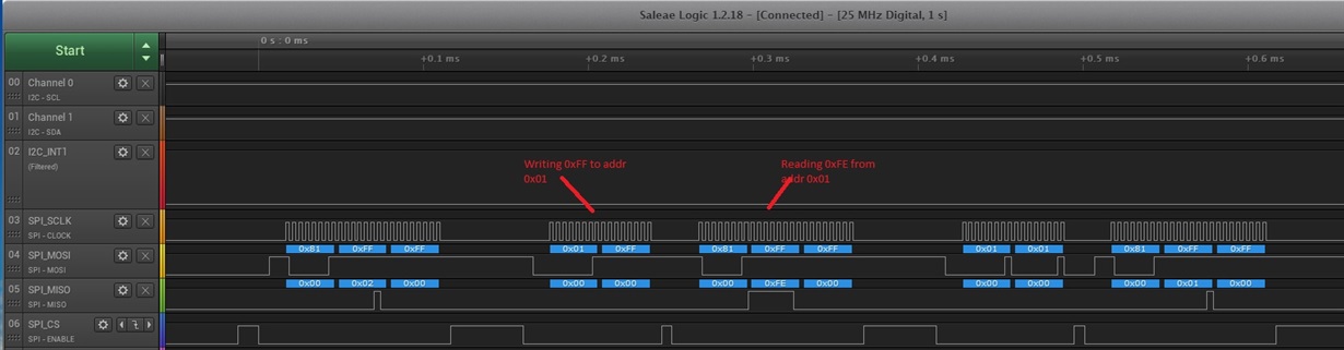

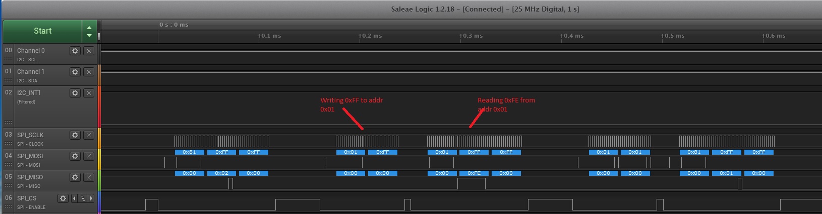

I am trying to interface to the ADS1293 through SPI.
The strange thing is that it looks like the ADS is somehow sending 1 bit to few.
If I write 0xFF to any register I only can read back 0xFE.
If I write 0x01 to a register I get 0x01 back.
If I write 0x02 to a register I get 0x02 back.
If I write 0x03 to a register I get 0x02 back!
Has anyone has similar issues with the SPI (I am only running it at 250kHz).
