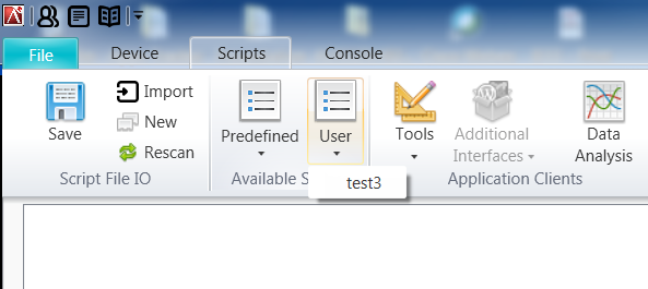

2) I am use "Delta-Sigma ADC EvaluaTIon Software". I saved the script. The next time I run the program and import the script, as a result, the program crashes.

    2) I am use Predefined Scripts: Basic startup with datarate 8KSPS. Its work. and I add WREG 0D 68 to turn on InternalREF. Then change Name "Basic startup with Datarate @ 8kSPS 1" and save as My1.xml. Restart program -> Scripts -> Import -> My1.xml == program crash.

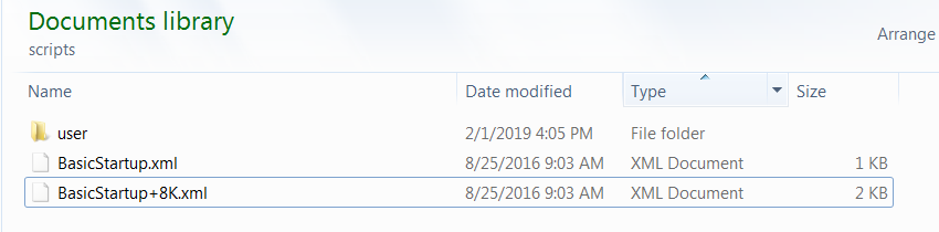

  • Kost,

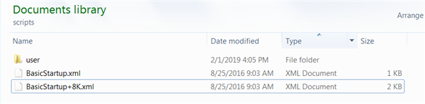

    I think I have a solution for your script loading problem. I believe that the software is looking for a "user" directory for the script. When the software doesn't find the directory, it doesn't create the directory and crashes the program.
    First, create a directory called user in the scripts folder. It should be in your documents library in Windows. The path should be something like this.
    C:\Users\*****\Documents\DSEvalSW\Devices\ADS131A04\scripts\user
    There are already some predefined scripts that come with the software, so it should look like this:
    If you have a script file (.xml), save it in the user directory. If you can't, just save the script and paste it in the directory.
    After that, open the software and click on the Scripts tab. Under the "User" button, you should be able to see the scripts saved in the directory and click on the script you want. If the "User" button is greyed out, then you may need to click "Rescan" so that the software can see the scripts directory.
    That should get you to your script. If you continue to have problems, post back and include the script file, and I'll see if I have similar problems. Also, the software has a log file that can be helpful for debug. You might want to include the files in the following directory:
    C:\Users\*****\Documents\DSEvalSW\Logs\
    Hopefully this solves your problem. Post back if you continue to have problems.

  • Thanks! it's work.

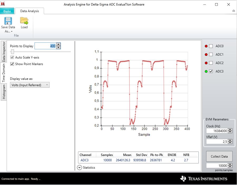

    I have a new problem in board:
    1) R89 is 0 Om. Is it right? I think is error. I connect via j10 through a buffer and as a result I get nothing. Replacing it with 10k - is ok.

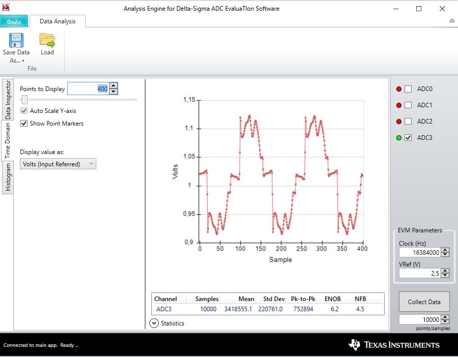

    2) I use the scheme "Figure 102. Typical Power Metering Connections" and the nominal values specified in "10.2.2 Detailed Design Procedure" from the datasheet ADS131A0x. I'm measuring  constant voltage by connection to the j9. I give through the calibrator 50B of a constant signal. The result is in the figure.
    If i use buffer - it's ok. May be i misconfigured ADC?

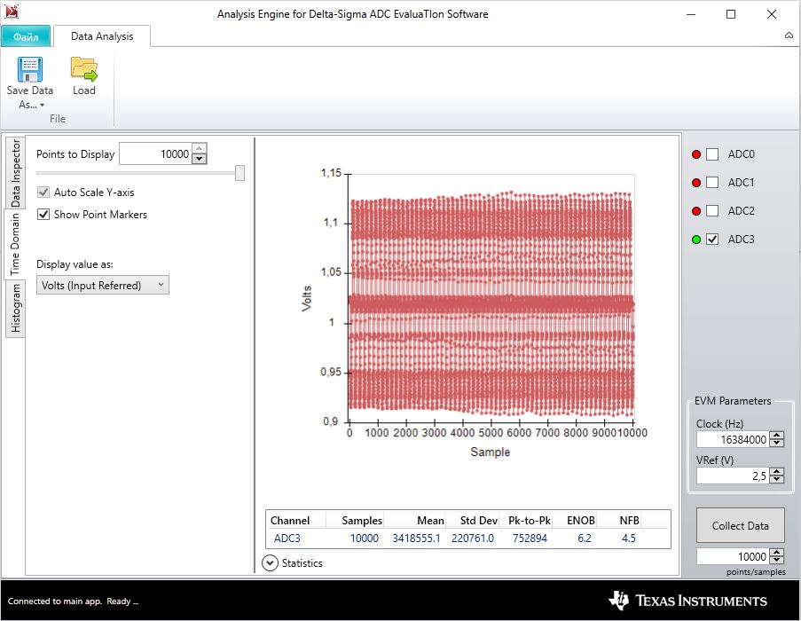

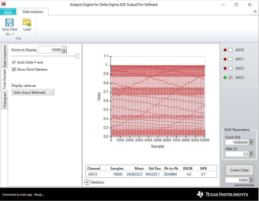

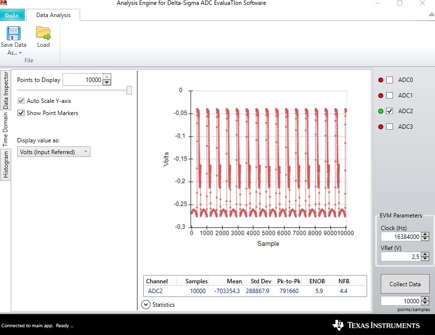

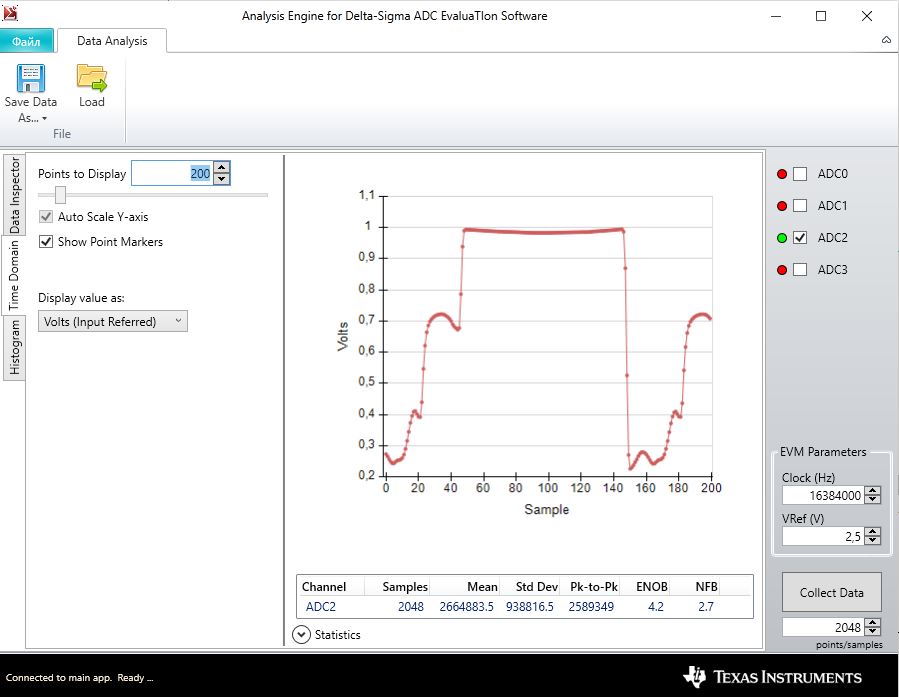

  • Hi Joseph,
    For the noise i have next results:
    Settings Board: bipolar supplies (JP11 2-3), internal reference enable (JP9 OFF and software enable), Script: Basic startup with Datarate @ 8kSPS
    1) Calibrator connected j10 1-2, buffer on. Input voltage 1V.
    it's ok.
    2) Calibrator connected j10 1-3, buffer OFF. Input voltage 1V.
    and increse
    3) Calibrator connected j10 1-3 by resistance divider, buffer OFF. Input voltage 180V, resistance divider 1MOm + 5.5kOm. Then in j10 just about 0.99V
    and increase
    4) Calibrator connected j10 1-2 by resistance divider, buffer on. Input voltage 180V, resistance divider 1MOm + 5.5kOm. Then in j10 just about 0.99V
    and increase
    5) Calibrator connected j9 1-2 by resistance divider. Input voltage 180V, resistance divider 1MOm + 5.5kOm. Then in j9 just about 0.99V. Calibrator groundin connect to EVM GND
    As you can see, the noise is periodic = 50Hz (our network). Calibrator n4-16.  ADS131 allows to measure a constant signal?
  • Kost,
    I'm not sure what is going on. I did have a chance to use the ADS131E04EVM earlier today, and I didn't see any problems with line cycle noise.
    For your test, I would start with focusing on what noise is coming in with the 1V signal without the buffer. For you, that would be the second case, without the high voltage resistor divider. What are you using for a voltage source? I would verify that you don't see the noise coming from your test voltage source.
    On a side note, it does concern me that your measurement from a voltage divider coming from a large resistor. Because the input is capacitively sampled, I generally don't like large series resistances from the measured voltage to the input of the ADC. This can cause some gain error.
    Joseph Wu

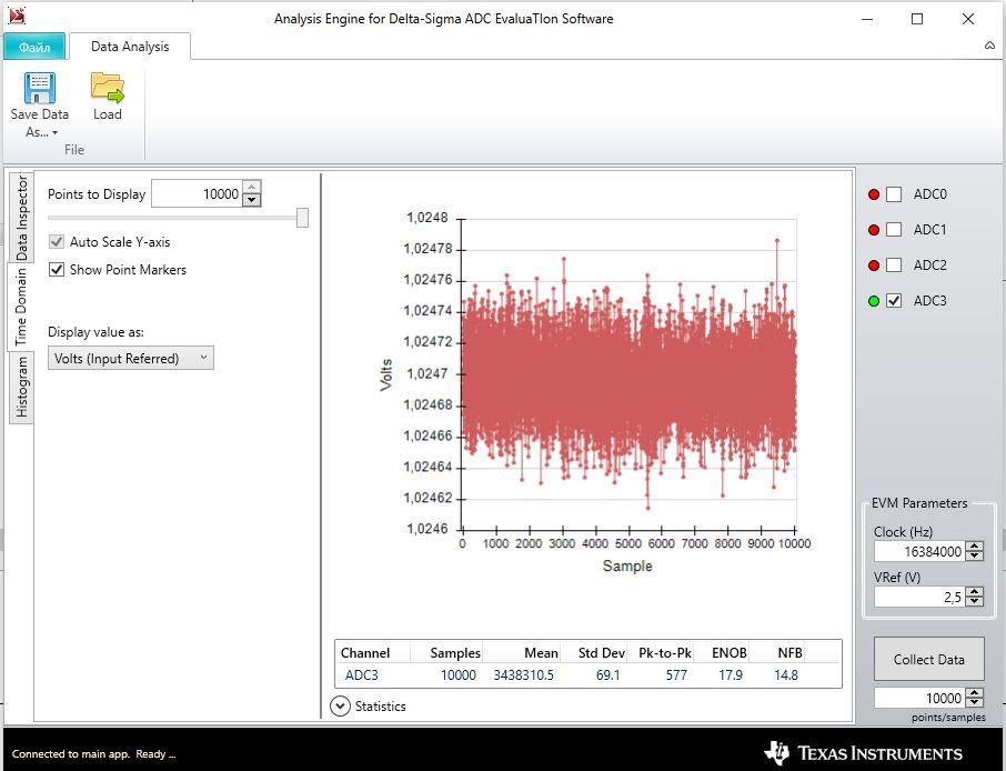

  • Joseph,
    I attempted the second case: if i plug in the oscilloscope getting good!)

    I will say that if the scope connection causes the signal to clean up, it could be that you have some sort of grounding issue. With the scope connection to earth ground, you may have removed a ground loop voltage that caused the noise that you see.
    Joseph Wu
  • Joseph,
    Everything became good. In the datasheet on the "Figure 102. Typical Power Metering Connections" did not pay attention to neutral and gnd. Shorted out 1-2 in j10 and everything became ok. Thanks for answers!
