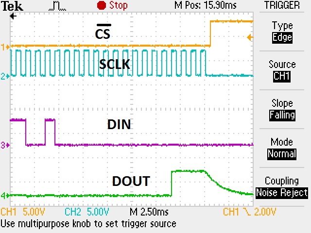

    We have one more query!
    Whenever the last bit of DOUT is high, the signal gets decayed slowly.
    I have attached the captures for your reference.
    Capture details:-
    We are trying to read the register having value 0Fh.
    Since the last bit of the register is one, the DOUT is getting decayed. But still we could infer the value as one, as the signal at DOUT remains high at the falling edge of the SCLK.
    Could you please explain the above behavior.
    Our Configuration,
    AVdd = DVdd = 5V. SCLK = 1KHz, Fosc = 2.4576MHz(through function generator), Fmod = 19.2KHz, Fdata = 10Hz.
    Thanks and Regards,
    Makesh
  • Hi Makesh,
    This is normal behavior for the ADS1218 in that after the last SCLK the output of DOUT changes to a high impedance state and is no longer driven.  This is indicated in the Timing Specification Table as t9 shown on page 9 of the datasheet. So there is a hold time after the last falling edge of SCLK to make sure the DOUT is read correctly.
