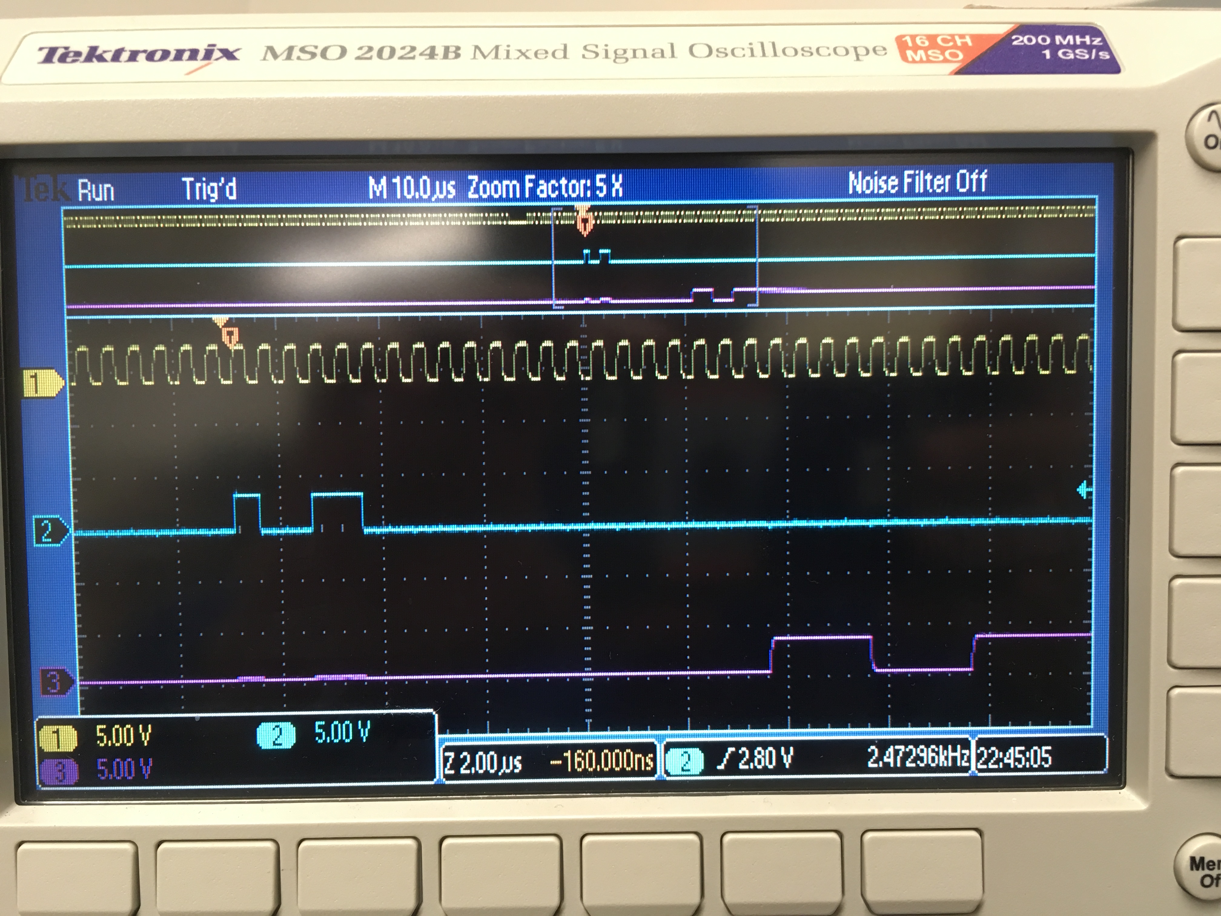

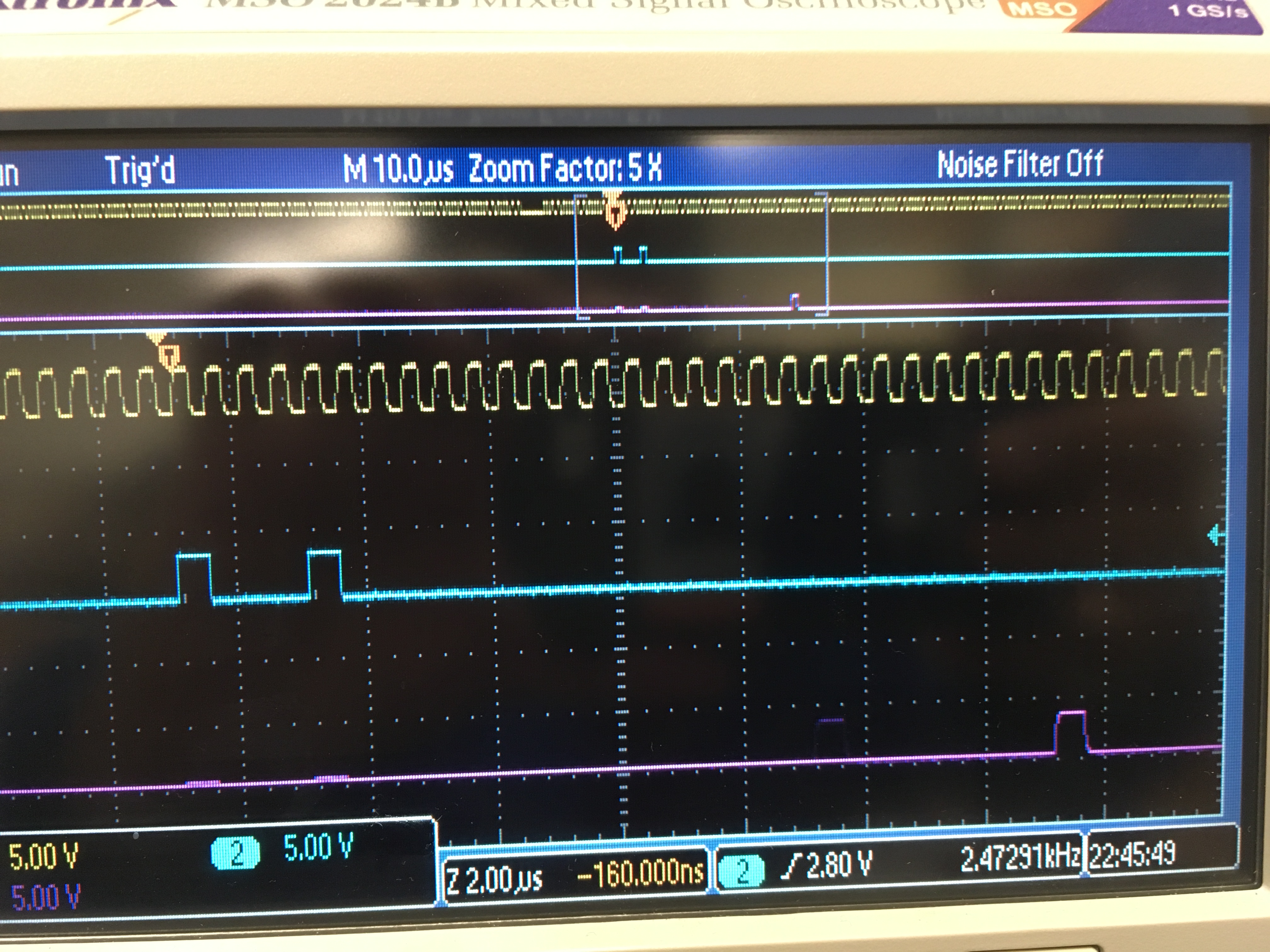

    Thanks for getting back to me. I made some changes and ran the code. It seems one of the issue is the sclk frequency used.  It seems I can read back the values of the registers
    01h,03h and 04h. The registers 00h gives random values and 02h returns nothing on the miso line. I am attaching the code and also the spi communication on the oscilloscope.

    Miso(Purple) - read back value(01h) =01h
    (13h) read back value = F0h
    similarly, I got E0h for (14h- register). I cannot also write to the registers it seems.
  • Hi Mustahsin,
    I have a couple of suggestions to try:
    • I would recommend using 8-bit SPI frame (instead of 16-bit frames as you are currently using). The reset command is only 8-bits and not all other commands will be a multiple of 16 bits, so it may be easier to simply send SPI command byte by byte.
    • The 2 MHz SCLK is a little fast for the ADS1256 if you're using the nominal 7.68 MHz ADC clock. The SPI clock should not exceed 1/4th the frequency of the ADC clock, so you might try using a a slightly lower SCLK frequency.
    • The continuous SCLK is probably causing some issues with reading registers. The ADS1256 has a t6 delay required between the command bytes and the register data byte(s). See figure 34 in the ADS1256 datasheet.
    • If you can try to capture a single RREG command on the oscilloscope with the /CS signal included so that you can see how this command is framed. For troubleshooting, it is okay to loop 1000 times, but I would recommend including the toggling of /CS in the loop to make it easier to differentiate between commands.
