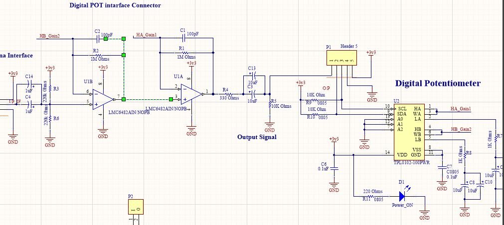

Hello TI,
I am Using TPL0102 Digital POT in my application circuit
1.Is it possible to use WRA and WRB resistor individually in TPL0102...? if yes please share some reference for development
2.TPL0102 WRA work when i use 0x00 and WRB work when i use 0x01 for instruction, how to use both resistor parallel for different application ...?
3.I want to use both resistor for different application, can i use TPL0102 like this ...?
i am sharing my Schematic circuit and application code

  • Hi Rahul,
    Thank you for your query. The A and B resisters are independent of each other and can be used in parallel as long as the voltage and current limits specified in the datasheet are respected. I see that you have 1K resistors in series with the DPOTs. But in case the amplifier saturates, there is a chance that the current through the DPOT exceeds 2mA limit if the DPOT resistance value is set at a low value. It is a better idea to increase th series resistance.

  • Hello Uttam,
    I change that series resistance current value of the resistance is 10K, which is used in series with DPOT
    But my question is can I use both reistnace at a time, if yes then what i need to change in code side or Hardware side
    Can i need to change change Wire.write(byte(0x01)); // sends potentiometer value byte ....?

  • Hi Rahul,
    You can use both the resistors simultaneously.
    In Arduino, in order to control the A resistor, you need to write:
    Wire.beginTransmission(TPL0102_ADDR); // slave address
    Wire.write(0x00); //register address
    Wire.write(0x88); // value of resistance A
    Wire.endTransmission(); // stop bit
    In order to control resistor B:
    Wire.write(0x01); //register address
    Wire.write(0x88); // value of resistance B
    Hope that works.

  • Rahul,
    The register address 0x00 id for the A - resistor and the address 0x01 is for the B - resistor.
    You can change both of them by writing them individually with two I2C write.
    You can also change them at the same time by using a continuous I2C (section 7.5.2.2 of datasheet) like as follows:
    Wire.write(0x00); //register address of resistor A
    Wire.write(0xAA); // changes the value of resistor A
    Wire.write(0xAA); // changes the value of resistor B. No need to specify the register address again. It increments automatically

  • Hello Uttam,
    It's working fine, Thanks for your valuable support
    I can Control DPOT A and B Simultaneously
