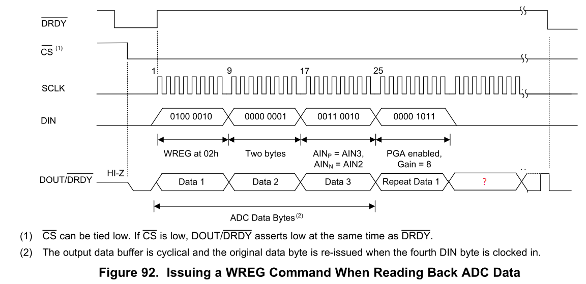

I have a question on Figure 92 of d/s.
I understand WREG can change conversion data like MUX and PGA Gain as the figure 92 shows.
My question is if the changed conversion data with new register setting will be sent after the WREG (total) 4 bytes are sent? In below figure I modified from the Figure 92,  I added continuous SCLK after Repeat Data 1 and marked "?" which I am asking if new converted data are set or Repeat Data 2?
I wonder if another /DRDY low-high transient is needed to wait for the new data out.
