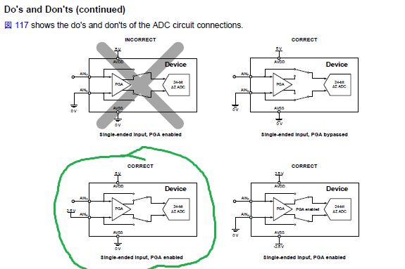

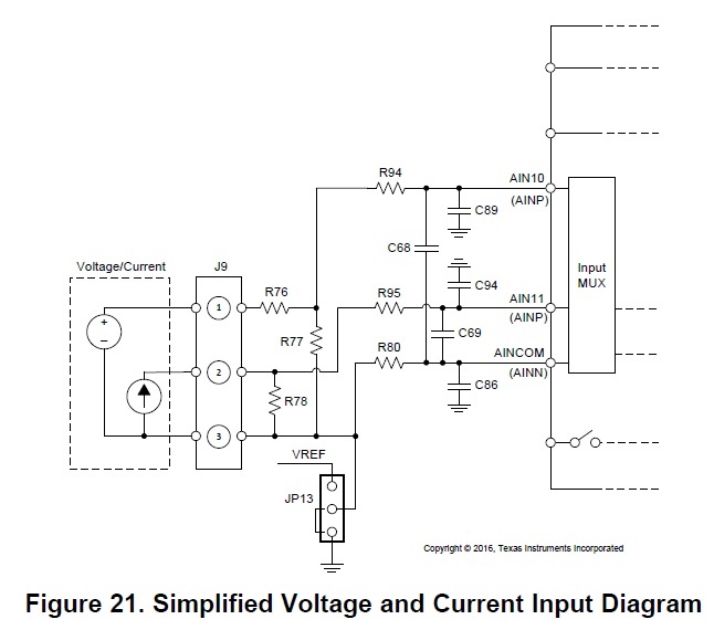

Customer would like to use ADS124S08 in single end and use AINCOM as common ground like the attached.
Actually their input(voltage/current) can be 8-ch in total and they use AINCOM as common ground. Is this no problem?
