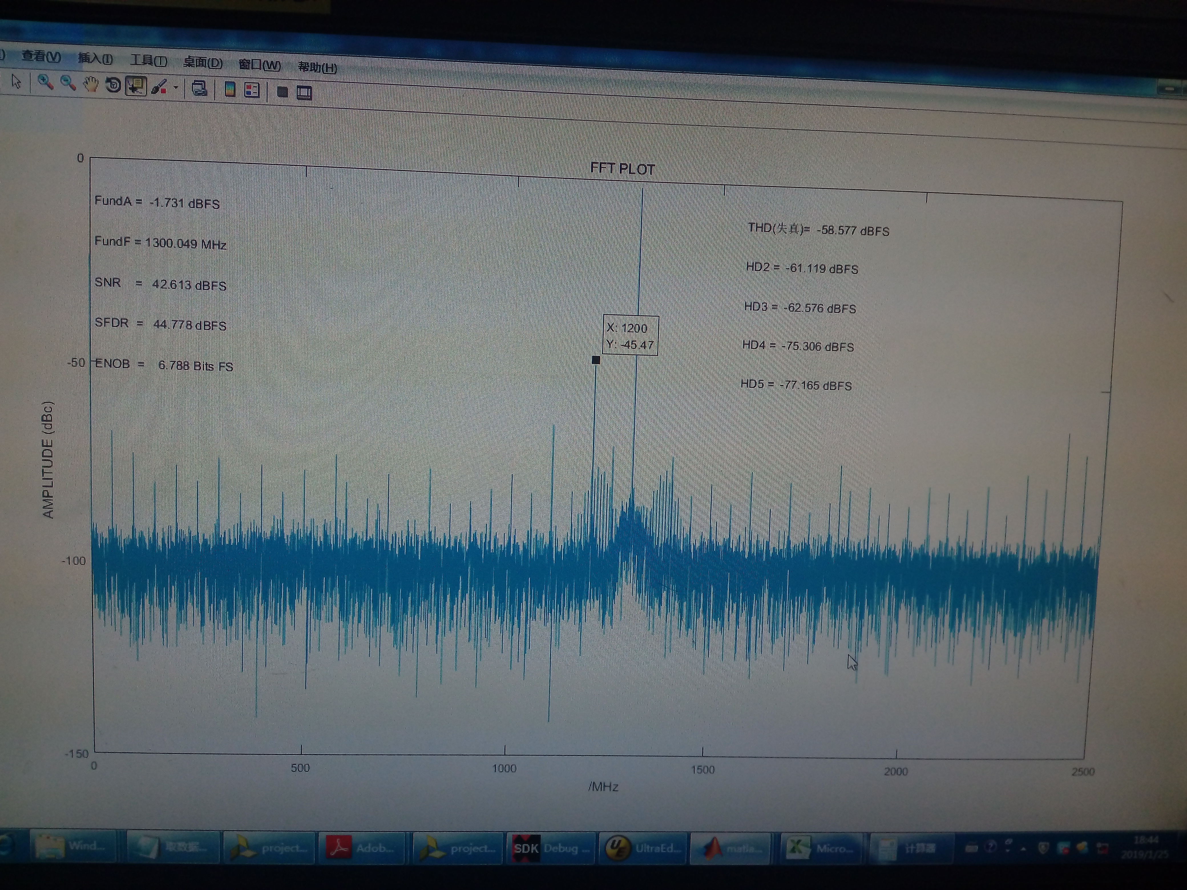

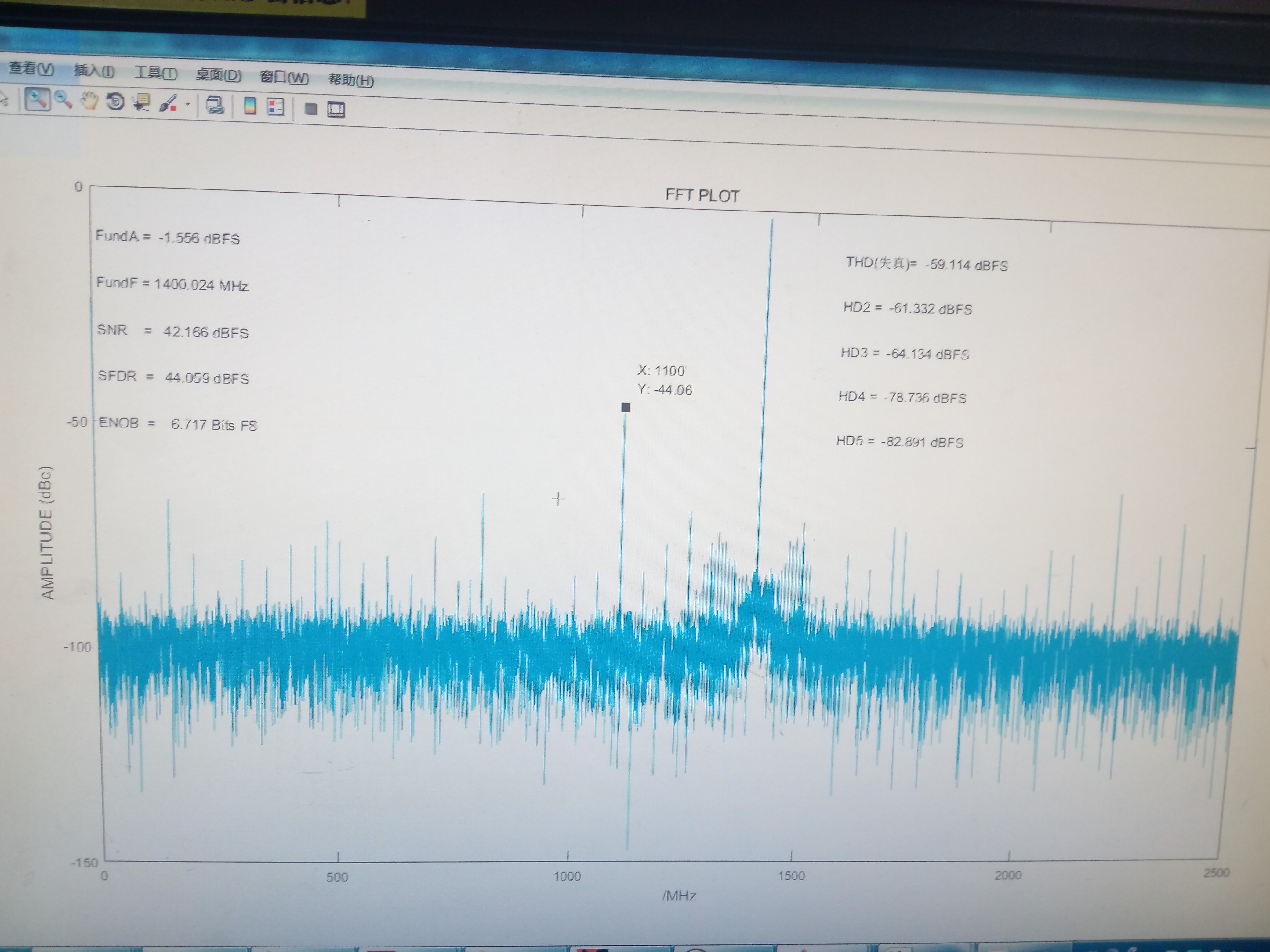

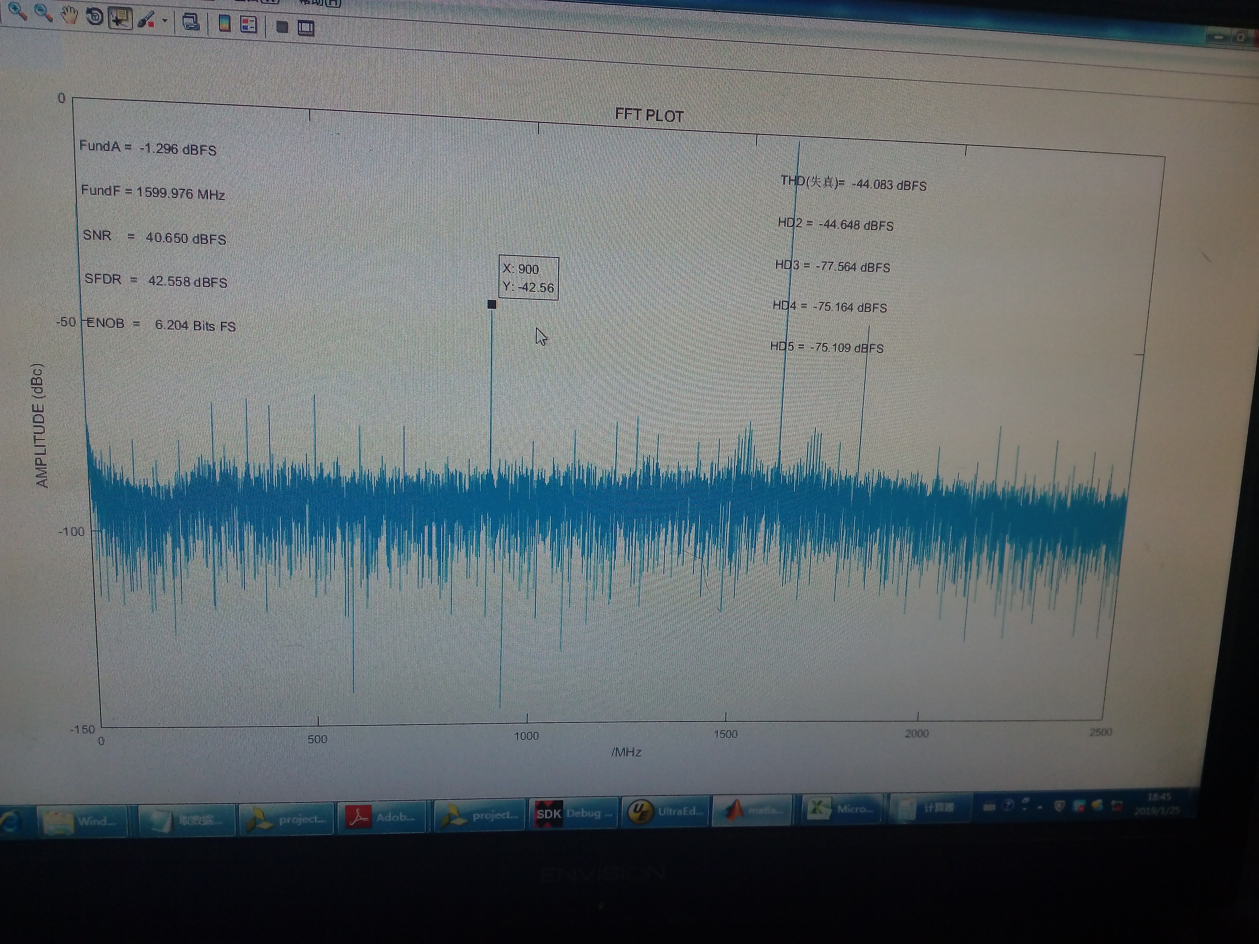

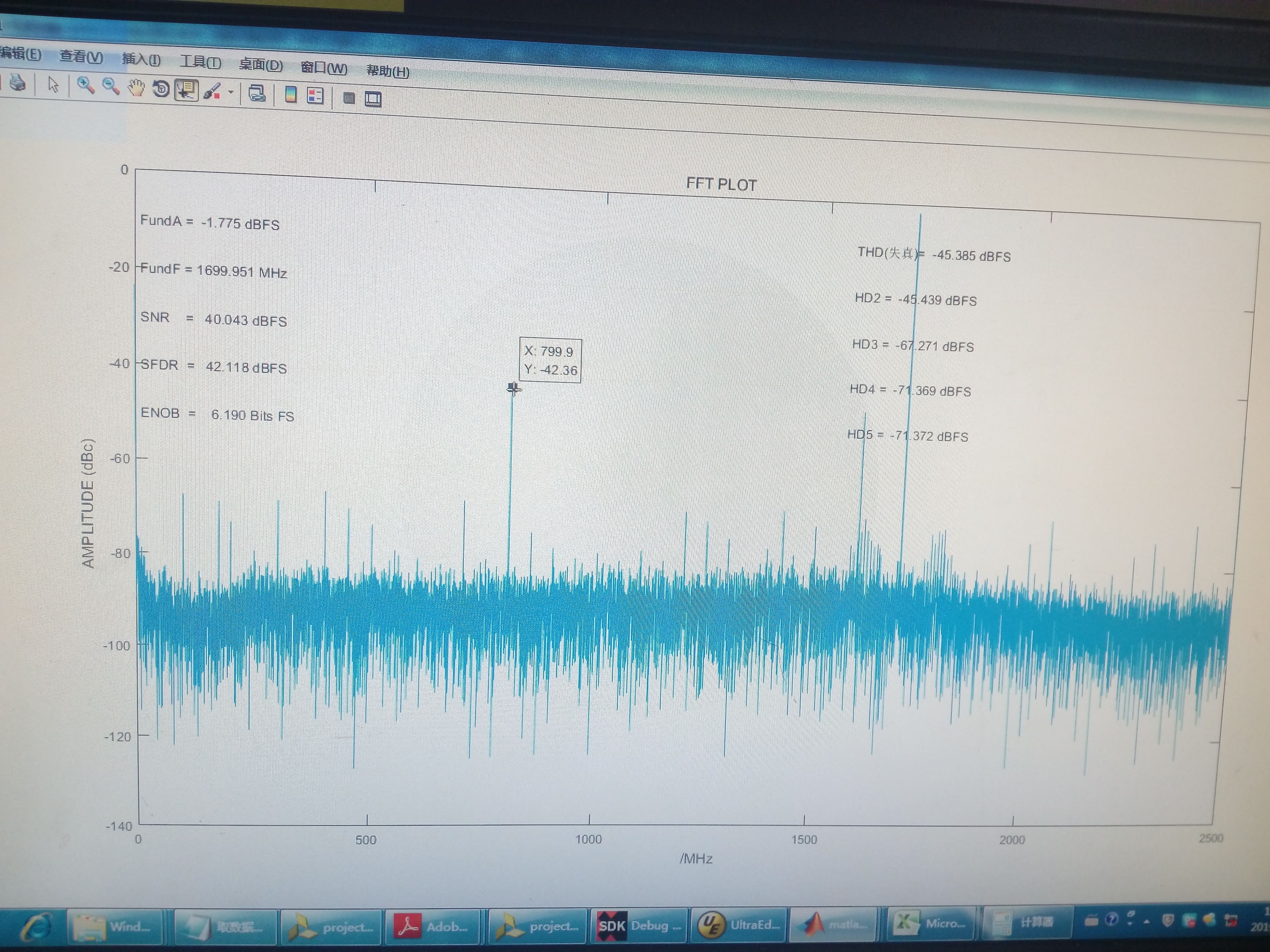

Hi there:
In our project, we use an ADC12DJ3200 in SINGLE-Channel mode, where the DES sampling rate is 5 GSPS with a corresponding JESD204B lane rate 5Gbps (JMODE 1). The INA+/- is used as ADC input port.
After the analog-to-digital convertion and spectrum analysing via matlab program, we found that the spur at Fs/2-Fin is too high in magnitude and worsened the SFDR performance(perhaps also worsened the SNR performance).
So, what may cause the problem? And how can we solve the problem or where to improve the SFDR and SNR performance?
Looking forward to your reply and many thanks!
P.S. the analysed spectrums are as follow:
Fs=5GSPS in Single-Channel Mode, 1st NZ, Fin=1.4GHz:
Fs=5GSPS in Single-Channel Mode, 1st NZ, Fin=1.3GHz:
Fs=5GSPS in Single-Channel Mode, 1st NZ, Fin=1.6GHz:
Fs=5GSPS in Single-Channel Mode, 1st NZ, Fin=1.1GHz:
And, the register configuration of ADC12DJ3200 is as follow:

  • Hi user
    I have some recommendations to update your register writing to improve the results you are seeing:
    See my markup to your original settings:
    u32 AD12DJ_REG_BUFFER[AD12DJ_REG_BUFFER_SIZE]=
    Move the reset sequence to the beginning:
                   0x0000B0,///reset
                   0x000030,///
    Add 10ms delay to ensure the device reset is complete.
                   0x020000, ////// clear JESD_EN,make sure again
                   0x006100, ///Always clear JESD_EN before clearing CAL_EN,
    Now these two commands above will do what is desired. In the original sequence the reset would return JESD_EN to 1 and CAL_EN to 1.
                   0x000200,
                   0x001000,
    Remove this write:               0x002300,
    If this is a single ADC application and deterministic latency is not required you can keep SYSREF processing and SYSREF receiver disabled. Also turn off the SYSREF signal to the ADC This will reduce SYSREF related harmonic spurs around the fundamental tone.
