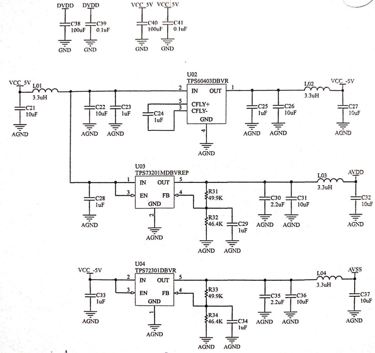

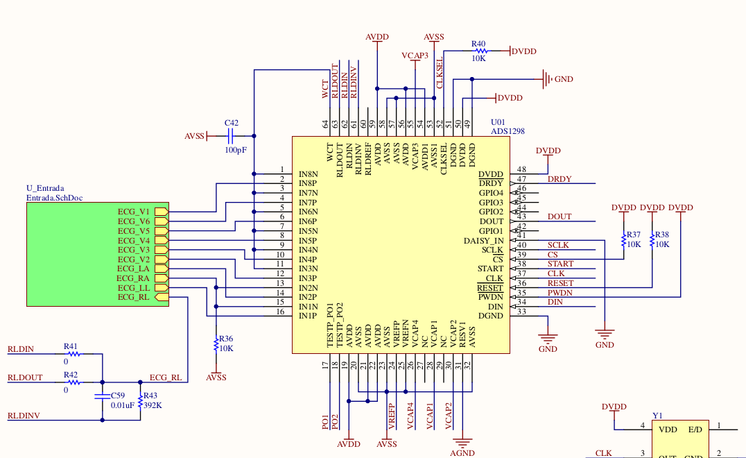

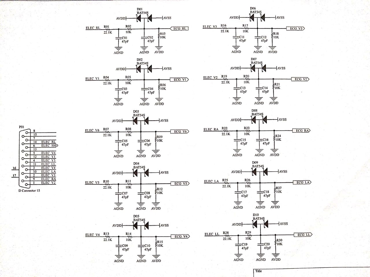

I want to show you a doubt regarding the ADS1298 and its right performance. The following is my schematic:

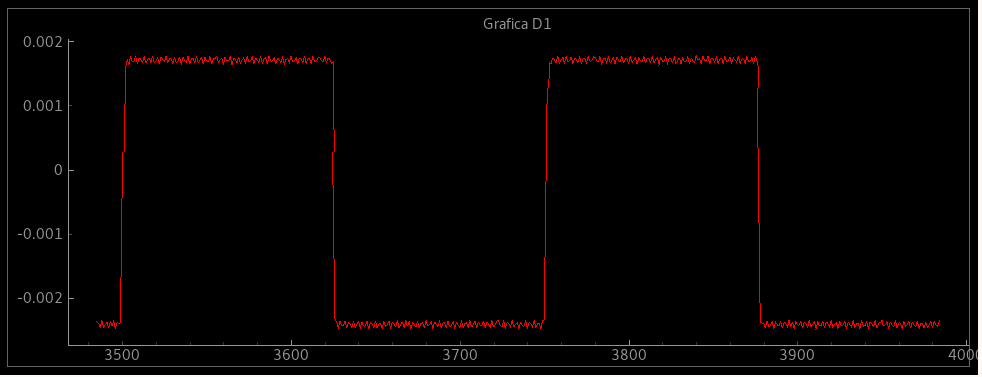

My design is supplied with AVDD= 2.5v and AVSS=-2.5v for a 5v total supply and configured with VREFP=4v. I have already aquired the ADS test signal with the following result:
My problem is, when I try to get the ECG signal through the 8 channels, it doesn't work, I get no result at all.
