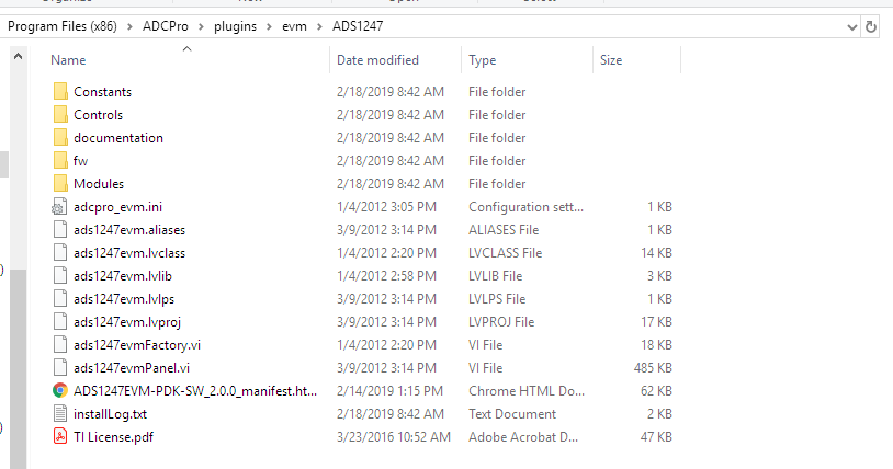

    ADCPro was designed to work with XP/Win7 and has not been fully tested to work with Win10.  I also use Win10 and have gotten ADCPro to work with some plugins such as the ADS1247.  I can see a number of possible reasons why you might see an error following installation.  ADCPro and the plugin installation requires Adminstrator rights for the install.  I'm unsure why you are seeing a FILEPATH error.  If you attempted to run the installer from the zip, I would highly recommend that you unzip (extract) the file first then run the installer.  The plugin should have installed in directory:
    Program Files (x86)\ADCPro\plugins\evm\ADS1247
    In the folder is a file called 'installLog.txt.  Can you send me that file when you reply to this post?

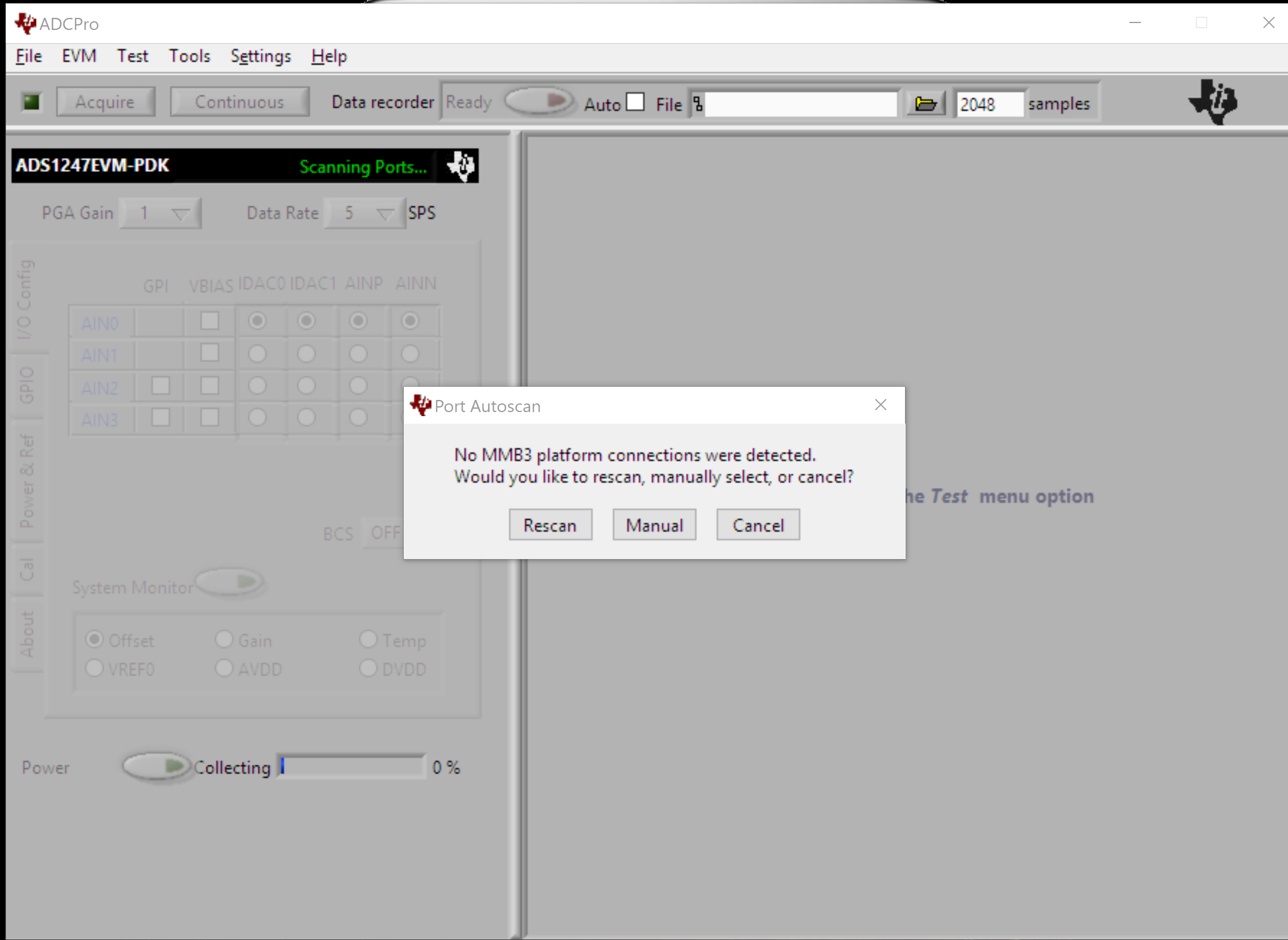

    The MMB3 uses special driver for the TUSB3410 to create a virtual COM port in the USB enumeration.  The MMB3 should not be connected to the USB when the driver is installed as a part of the plugin installation.  Win10 may need a different driver installation as I'm not sure the TUSB3410 drivers were signed.  You can download more recent driver from the following link:
    http://www.ti.com/lit/zip/sllc428
    The MMB3 you have is loaded with the test firmware used in production testing.  Each EVM used on the MMB3 has it's own version of firmware.  When the plugin starts there is a search for the correct COM port used for the MMB3.  If the port cannot be found there will be an attempt to download the firmware required for communication.  If you know the correct COM port you can manually select the proper port for communication.  The firmware download process will start and you will need to follow the screen prompts in the GUI for proper installation.
    If you did not install ADCPro with Administrator rights, you will need to uninstall/install ADCPro.  Next steps would be to make sure you are using Administrator rights and then uninstall/reinstall the plugin making sure the MMB3 is not connected and ADCPro is not running.  Install the most recent driver for the TUSB3410 used on the MMB3.  Plugin in the MMB3 and make sure that it is properly recognized by the OS (and check which COM port is assigned in Device Manager).  Start ADCPro, and load the plugin.  You should see something like is shown above with the firmware installation process starting.

  • Hi Dominik,
    I must say I'm very stumped. It seems like the program is not finding the files or that they may be corrupted. I used the same download as you, so I don't think there is a file corruption. We can try to narrow things down a bit by loading one of the other standard plugins, such as File Reader, or TripleGen. That would at least tell us if it is a main application issue or something specific to the plugin.
    I recently had a weird issue with another customer (different software) that acted in a way where the program would crash at a certain point. The issue was related to anti-virus software. They disabled it and reinstalled and now it works as expected. Does the file structure look the same to what I initially showed in my first post for the plugin directory? This may also show a clue.
    I will continue to look into this some more, but I have a hard deadline coming up so it might be a few days before I can really dig into it. There was one thing I did notice and that I should mention is that the program installation is on the C: drive but it appears that the users's folders are on the D: drive based on the installation info. There is a file search path in the adcpro.ini file (under C:\Program Files (x86)\ADCPro). Open the file with a text editor and verify the paths are valid. Also send me the contents of the file as well.

  • Hi Bob,
    So, the plugin directory looks exactly the same as yours, file names and file sizes are the same. I also checkt the ini file and every path is valid except for the shared directory. That folder does not exist...

  • Hi Dominik,
    Were you able to try and load one of the standard ADCPro plugins?  There are two standard plugins that should show up when you click on the EVM drop down menu in ADCPro besides the ADS1247EVM plugin.
    Bob B
  • Hi Bob,
    my problem is solved now... Initially I installed ADCPro without standard plugins. After reinstalling ADCPro with those plugins (to check, if they work properly) for some reason also my required plugin worked.
    thanks for your help!
    Best regards, Dominik
