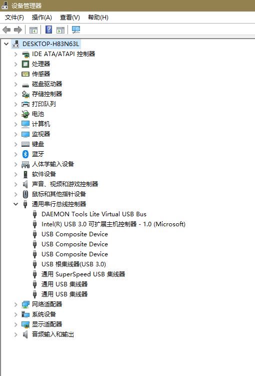

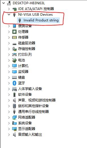

I want to use ADS1298ECG software, and my OS is windows 10.

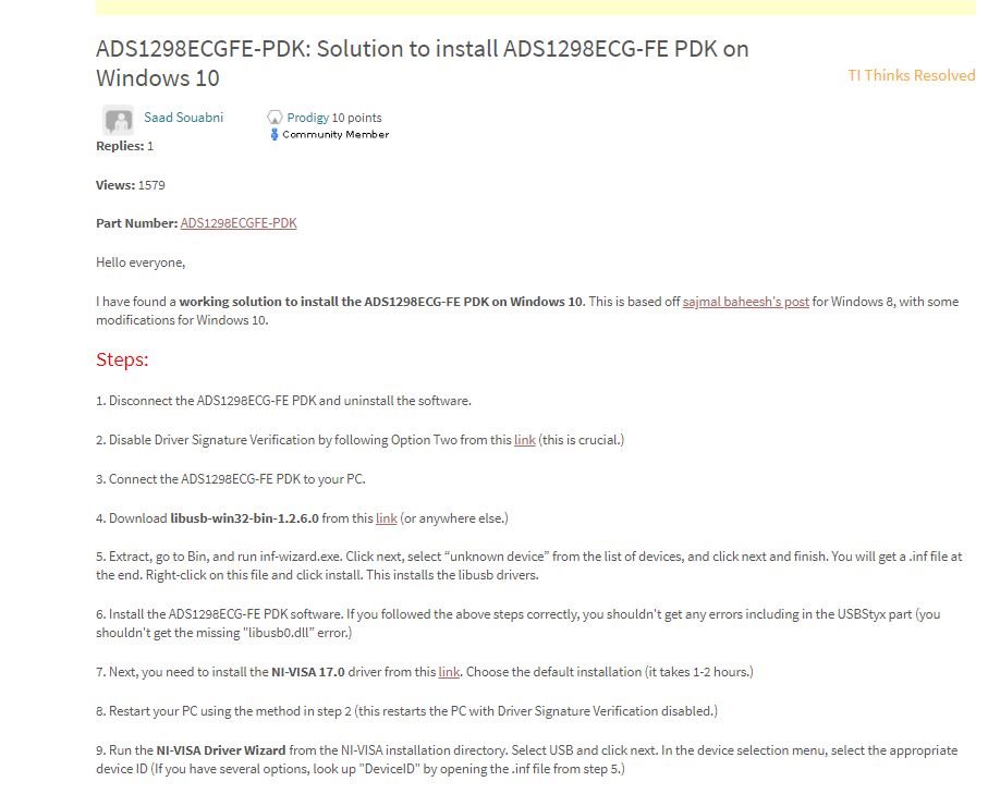

I followed the method on this post -> https://e2e.ti.com/support/data-converters/f/73/t/656505
But it seems... well, I can't tell what happened.

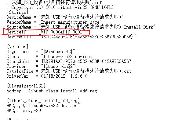

Here is the .inf file given by inf-wizard.
The Chinese  word means "Unknown USB Device ( Device Descriptor Request Failed )".
Maybe I should first uninstall some drivers, but I don't know which ones should be uninstalled and how to.
