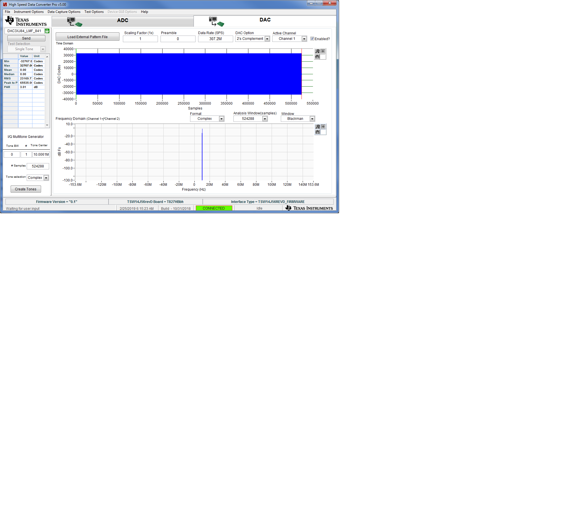

i am using TSW14J56EVM +DAC3XJ8X set up and the basic set up is completed. i am able to generate pattern up to 1 M sample( MS excel has a limit)  by loading .CSV file format.
my concern is, if i am using 307.2 MSPS at four channels and total number of maximum samples i can generate is 2G 16 bit samples then total achievable length of the pattern should be= 2G/(307.2M*4)=1.62 seconds.
is my calculation correct about TSW14J56EVM...? if so how can i upload external pattern file consisting large number of samples..?
Because i want to generate pattern at each chanell about 300~400 millisecond length.

  • Ravikant,
    Using the I/Q Multitone Generator, I created a 2G test file, as shown below. I then saved this a .csv file which is attached. This is what your file should look like if you want 4 channels of data totaling 2G. After creating this file, use the "Load External Pattern File" button in the GUI.
    Jim

  • Hi Jim
    thanks for your reply
    As you mentioned in your answer, i can see 524288 samples per channel , totaling for four channel =524288*4=2097152. I think, it is total 2 M( mega)samples.
    i want to generate 2 G samples, because if i am using 16 bit data so i can store up to 2 G samples in external DDR memory of 32 Gb attached to TSW14J56.
    please suggest me some prompt solution.
    thanking you
    Ravikant
  • Ravikant.,
    Just build a 4 column .csv file with each column having 536,870,912 samples. This will max out the DDR3 memory.
    Jim

  • Ravikant,
    More info from our software team:
    Currently we don’t support loading bin files in HSDC Pro DAC Tab. We can create a CSV file containing 536,870,912 samples using LabVIEW or Matlab and load in HSDC Pro. It is a constraint in MS-Excel that doesn’t allow to view or create huge files. But the same is achievable through LabVIEW or MATLAB.
    Jim
  • Ravikant,
    HSDC Pro can utilize the whole DDR memory of TSW14J6 when a file (.csv or .tsw) of enough size is loaded into HSDC Pro. No limitations here.
    A user can create a CSV file containing 536,870,912 samples or more using LabVIEW or Matlab and load in HSDC Pro. Can you try to do this? CSV file can be generated with a generic text file creating library in LabVIEW or Matlab.
    The limitation of the HSDC Pro I/O multi-tone generator is due to a combination below two items,
    1. Limitation of the signal generation library used in HSDC Pro
    2. FFT library that calculates and shows the freq domain representation of the signal
    I don’t think we can modify this as the file loading option enabled just to rectify this limitation.
