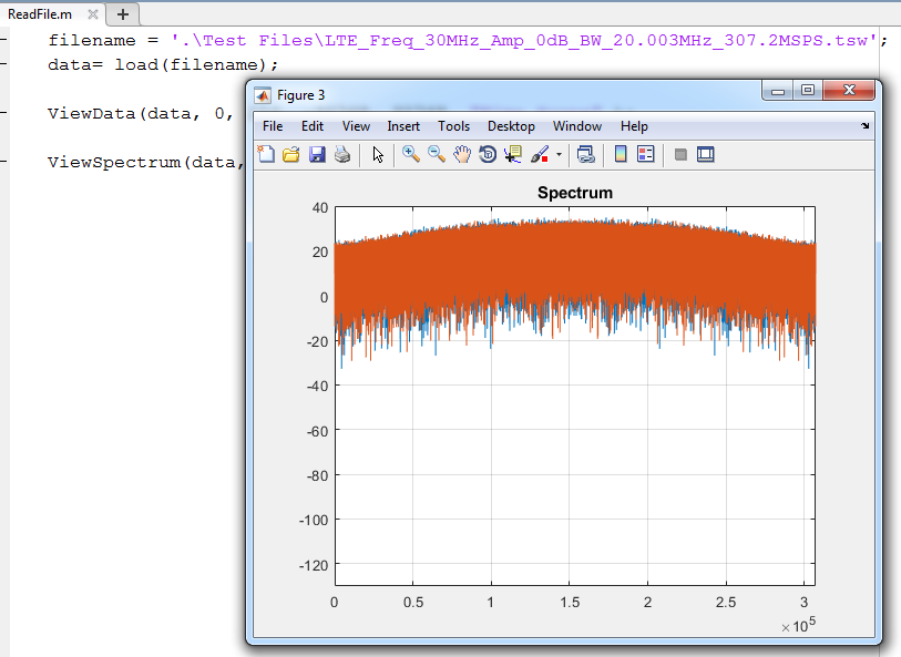

I purchased TSW1400EVB and TSW3085 EVB, verfiied the WCDMA perfoamance. Later, we have made our own board of FPGA + DAC3482 chip. We verified of sending simple sine wave/square wave and etc, everything was correct.
Now,  it is time to use WCDMA waveform and measure performance on our own board. We use "TSW1400_pattern_gen_win7" software generates WCDMA signal, but it doesn't seem to be correct as we only see wideband noise from spectrum analyzer. We guess the generated data file format maybe different than DAC3482 data (16bitI then 16bit Q), moreover the file may contains more information than IQ data....
Is there any document available that explains "TSW1400_pattern_gen_win7" generated file format or does anyone know where can i find this information? We do need to measure the WCDMA  and LTE performance in house before sending to customer.

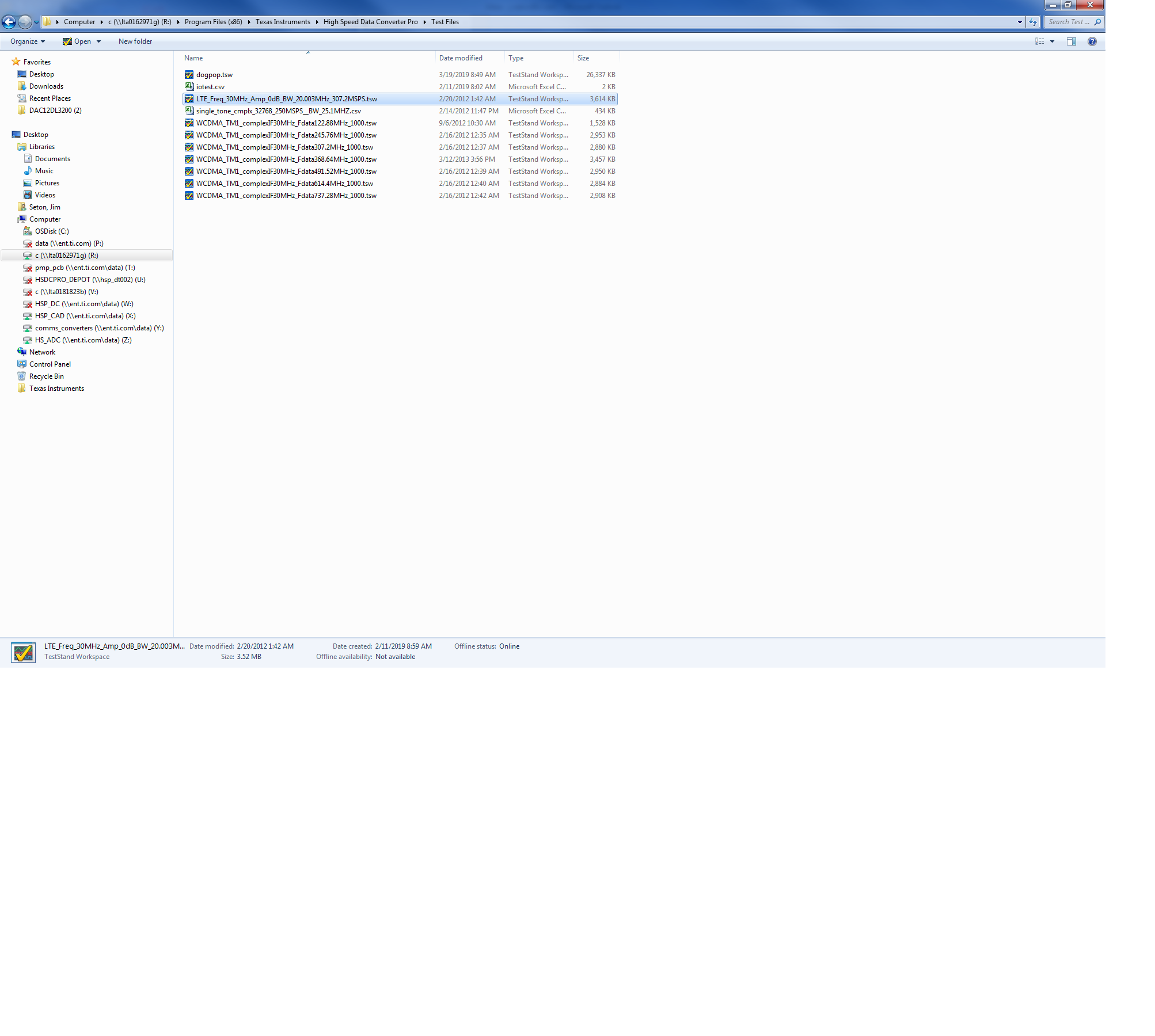

    I did not see any issues with the files created by this software. Can you send screen shots of the software that was used to create the test file? Can you also send the .tsw file created by the software? How are you implementing the file? The file is made up of columns, with each column a DAC input and either I or Q data. This software was created many years ago and the engineers are no longer with us. I am afraid there is no documentation available for this but I am still searching. Have you tried using any of the existing WCDMA test files that can be found in the location shown below?

  • Hi Jim
    Yes, we can open the file with a text editor, but ....
    I tried to use this LTE file on my own board, but got nothing from spectrum analyzer. I also tried to load this IQ file into Matlab, the FFT result shows only wideband noise. However, I did see the good ACP performance with TSW1400 and 3085 EVB;  thus, i realized the iq file data may not be as simple as we can see. This is the reason why i posted this question 2 weeks ago  as I have to measure ACP performance of my own board in house prior to sending to customer.
